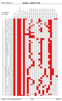

I made this table to make it easier to see which sources can be used by each peripheral.
Mark

TCL_1
Hi Mark,
Thanks for your sharing.
Do you know the mainly differences between OSC24M and RC48M_DIV2? power consumption or what? I just wonder why the SDK use RC48M_DIV2 as clock root of most peripherals, is there any benefit that change it to OSC24M source?
I guess there's no standard answer, just discussion. thank you again.
