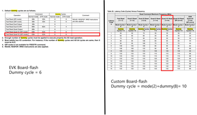

The problem is that Read and Write of the SPI method using D0 and D1 work, but Read and Write of Quad mode do not operate normally.
SPI Write -> SPI Read = normal operate
Quad Write -> Quad Read = Not operate
Quad Write -> SPI Read = Not operate
SPI Write -> Quad Read = some action (some error value output)

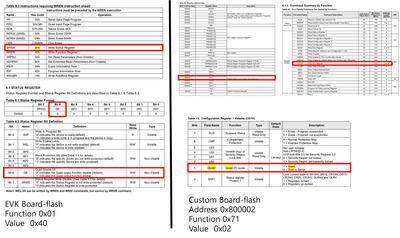

status_t flexspi_nor_enable_quad_mode(FLEXSPI_Type *base) in the function
uint32_t writeValue = FLASH_QUAD_ENABLE; => 0x02; (*) FLASH_QUAD_ENABLE = 0x40U, quad mode enable bit changed according to S25FL128LAGMFI010 change

[4 * NOR_CMD_LUT_SEQ_IDX_READ_FAST_QUAD + 1] = FLEXSPI_LUT_SEQ(
kFLEXSPI_Command_DUMMY_SDR, kFLEXSPI_4PAD, 0x06, kFLEXSPI_Command_READ_SDR, kFLEXSPI_4PAD, 0x04),
=> kFLEXSPI_Command_DUMMY_SDR, kFLEXSPI_4PAD, 0x0A, kFLEXSPI_Command_READ_SDR, kFLEXSPI_4PAD, 0x04),
(*) The function of fast read quad mode is the same as 0xEB, but there is a difference in the dummy cycle 0x06=>0x0A
Only when dummy cycle 8 is applied, all data read is incorrect. When 10 is applied by adding mode cycle (2) to the dummy cycle, some are read as normal, and some are incorrect.

QE bit is not enabled properly for S25FL128 with your code change. that's why Read and Write of Quad mode do not operate normally.
For IS25WP128, QE bit is in Status Register (1byte sequence), but it is in Configuration register for S25FL128 (2bytes sequence)
