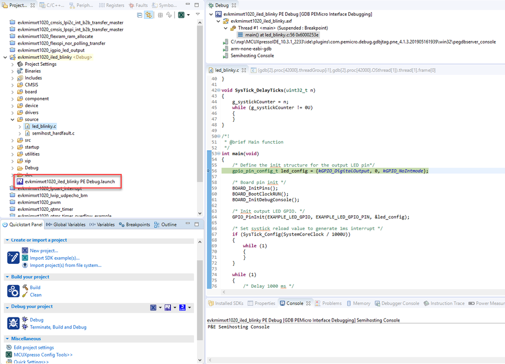

Hello Gustavo,
I made some tests on my side and I was able to debug using a Multilink Universal FX Rev. B debugger. I used the newest version of MCUXpresso IDE and an SDK example. I had to remove J27 and J28 from the RT1020-EVK to debug correctly, see image below.
What IDE are you using? Are you using an example from the SDK or your own project?

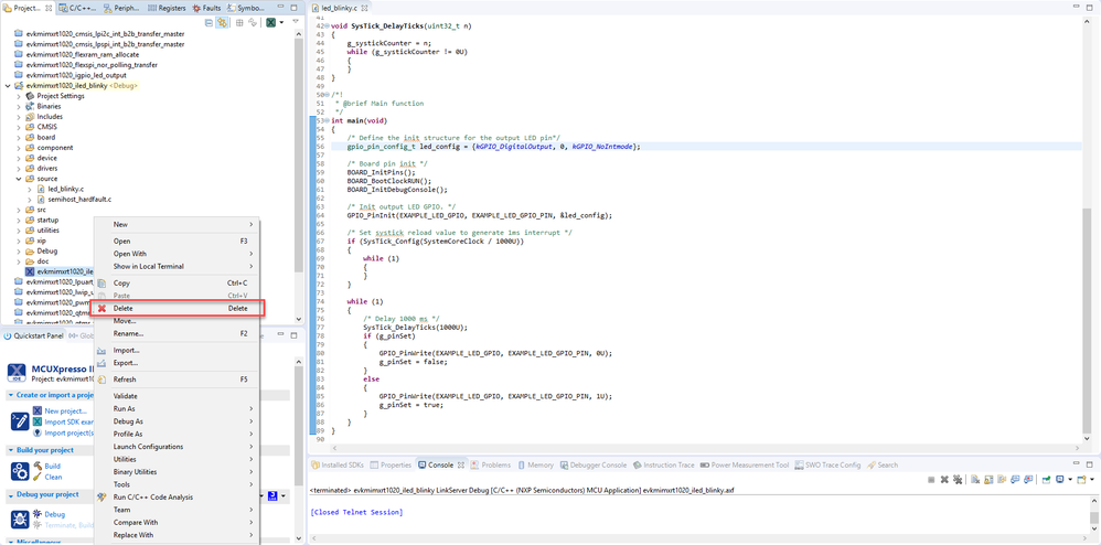

Hi Gustavo,
Are you connecting the debugger to J16 connector? Are you using MCUXpresso IDE? If so, when you debug with the OpenSDA and then you want to debug with another debug probe, you need to delete the debug configuration. To do this please follow the next steps:
  1. Select the debug configuration file.
  2. Right click on it.
  3. Delete.
