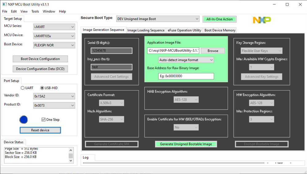

FelipeGarcia
Are you providing power correctly to the board? What is your setting of J1 in the EVK?
Also, could you please confirm if you can connect to ROM by using MCUBoot Utility as below? You can find more info of this in the this link: https://mcuoneclipse.com/2019/01/02/regaining-debug-access-of-nxp-i-mx-rt1064-evk-executing-wfi/
