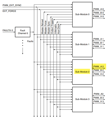

I'm working with the imxrt117x and 'm trying to run a simple PWM on output PWM(A,2) with this code:
  pwm_config_t       pwmConfig;
  pwm_signal_param_t pwmSignal[1];
  uint32_t           pwmSourceClockHz = PWM_SRC_CLK_FREQ;
  uint32_t           pwmFreqHz        = 10000; // 10 kHz frequency
  // Default PWM configuration (init PWM for a submodule)
  PWM_GetDefaultConfig(&pwmConfig);
  // Adjust the configuration for our specific use case
  pwmConfig.enableDebugMode       = true;
  pwmConfig.reloadLogic           = kPWM_ReloadImmediate;
  pwmConfig.pairOperation         = kPWM_Independent;
  pwmConfig.clockSource           = kPWM_BusClock;
  pwmConfig.prescale              = kPWM_Prescale_Divide_4;
  pwmConfig.initializationControl = kPWM_Initialize_LocalSync;
  /* Initialize submodule 2 the same way as submodule 1 */
  if (PWM_Init(BOARD_PWM_BASEADDR, kPWM_Module_2, &pwmConfig) == kStatus_Fail)
    PRINTF("PWM initialization failed\n");
    return 1;
  // Configure the PWM signal for channel A and channel B
  pwmSignal[0].pwmChannel       = kPWM_PwmA;
  pwmSignal[0].level            = kPWM_HighTrue;
  pwmSignal[0].dutyCyclePercent = 50; // 50% duty cycle
  PWM_SetPwmLdok(BOARD_PWM_BASEADDR, kPWM_Control_Module_2, false);
  // Set up PWM signals
  PWM_SetupPwm(BOARD_PWM_BASEADDR, kPWM_Module_2, pwmSignal, 2,
               kPWM_SignedCenterAligned, pwmFreqHz, pwmSourceClockHz);
  // Load the configuration
  PWM_SetPwmLdok(BOARD_PWM_BASEADDR, kPWM_Control_Module_2, true);
  // Start the PWM
  PWM_StartTimer(BOARD_PWM_BASEADDR, kPWM_Control_Module_2);
Still I don't get why it's not working.
I got also the pinmuxing:
  IOMUXC_SetPinMux(
      IOMUXC_GPIO_AD_28_FLEXPWM2_PWM2_A,      /* GPIO_AD_28 is configured as FLEXPWM2_PWM2_A */
      0U);                                    /* Software Input On Field: Input Path is determined by functionality */
Is there anything else that I need to take into account?

EdwinHz
Hi @illy777,
I believe the issue lies on the pin that you are initializing.
Your code sets up Module FLEXPWM2, Sub-Module 2, channel A.
This, because you are using "BOARD_PWM_BASEADDR", which is defined as PWM1:
/* The PWM base address */
#define BOARD_PWM_BASEADDR PWM1
However, the pin you are using is for the FLEXPWM2 module, rather than FLEXPWM1. You can see its name makes reference to Module PWM2, Submodule 2, Channel A: "IOMUXC_GPIO_AD_28_FLEXPWM2_PWM2_A"
The pin you should set-up for the configuration you are using is GPIO_AD_04 (or GPIO_EMC_B1_27):
BR,
Edwin.
