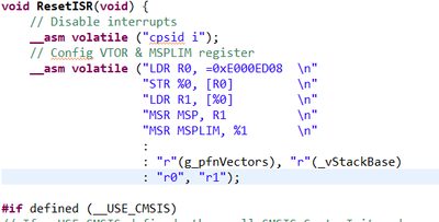

I further tried programming in debugging mode .
The program stuck at resetISR()

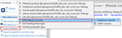

HI
Can you print hello world to simihost?
Below is to switch output to semihost:
Jun Zhang
1,432 Views
Velmurugan0534
Hi @ZhangJennie ,
Thanks for your prompt reply.
After changing the console to Semihost still i face the same issue.
Could you please help me out ?
In debugger mode i see that it hits ResetISR()
