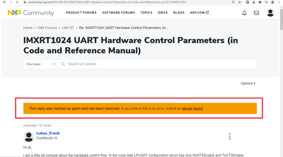

This post is continuation of my first post ( First Post ). System tagging my post as spam. Like you see below:
