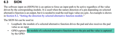

in the i.MXRT 106x MCUs, if I configure a pin as the receiver pin for a UART module, how can I read the value of that pin (HIGH or LOW) at any time through the GPIO module (or any other way)?
I thought if I enabled the SION mode in the mux_ctrl_pad register, it would be possible but it doesn't seem to be working. Any idea what can I do?

I'm experiencing similar behavior right now. I'm using an i.MXRT 1176. I'm attempting to configure a pin mux for the XBAR function, but also read the value through GPIO. I've set the SION bit but can't seem to read the value through GPIO. I can read the value just fine if I configure the mux for the GPIO function so I know I don't have anything else misconfigured.
The reference manual states "Force the selected mux mode Input path no matter of MUX_MODE functionality." That would seem to imply the input path is only enabled for the module selected in the mux mode. I'm starting to believe it.

Regarding this comment,  that would seem to imply the input path is only enabled for the module selected in the mux mode. I'm starting to believe it.
I agree with this, see the description from this AN

Hi Daniel,
I actually believe so too, especially because the following is written in the manual as one of the reasons the SION mode would be useful: "Module x drives the pad and also receives pad value as an input".
So I imagine that the input path that is forced by setting the SION bit is only to the module selected depending on the mux configuration. I hope there is a way to do the reading of the pin somehow.
