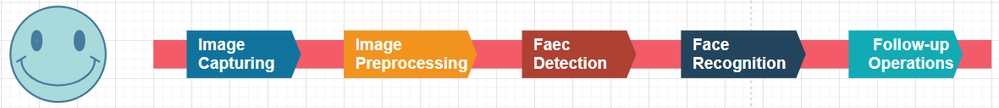

Actually, face recognition technology is used in many scenes in our daily life, for instance, when taking pictures with the mobile phone, the camera software will automatically recognize the faces in the lens and focus, scan face for real-name verification when registering the App and scan face for pay, etc.
The basic steps of face recognition are shown in the below figure. Firstly, the camera captures image data, then through preprocessing such as noise elimination and image format conversion, the image data will be transmitted to the processor for face detection and recognition calculations. After recognizing the face successful, continue to do the follow-up operations.
Fig1 The basic steps of face recognition

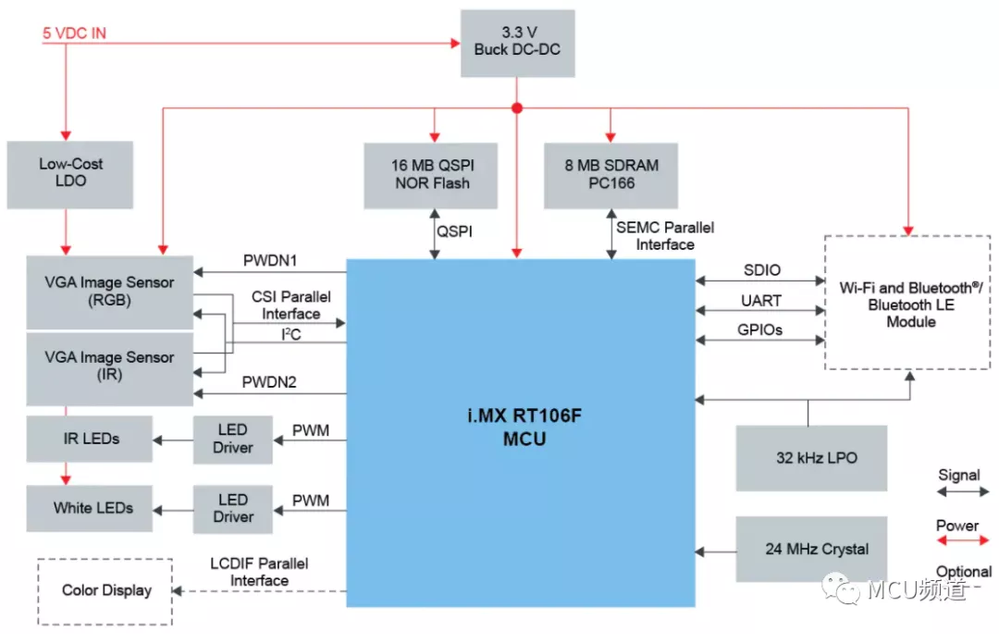

i.MX RT106F MCU based solution for face recognition
The below figure is the block diagram of i.MX RT106F MCU-based solution for face recognition provided by the NXP. Comparing with the general processor (CPU) solution, it has comparative advantages in cost and power consumption. Further, the PCB size will be smaller too and the MCU usually can boot up within a few hundred milliseconds even with RTOS, versus to the boot-up speed of the processor (CPU) equipped with a Linux system that is about 10 seconds, it will give customers a better user experience.
Fig2 i.MX RT106F MCU based solution for face recognition
Of course, the i.MX RT106F MCU-based solution face recognition solution is not intended to replace the solution based on the processor (CPU). As aforementioned, face recognition technology has a lot of application cases, and it will definitely be used in more fields in the future, so the MCU-based face recognition solution provides customers and the market with another choice.

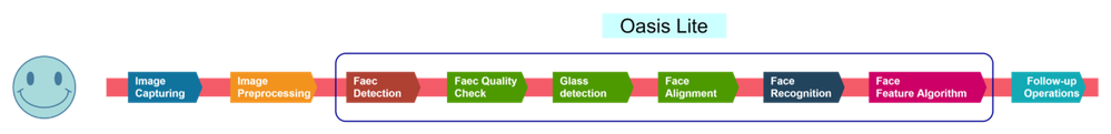

The i.MX RT106F face recognition crossover processor is an EdgeReady™ solution-specific variant of the i.MX RT1060 family of crossover processors, targeting face recognition applications. It features NXP’s advanced implementation of the Arm Cortex®-M7 core, which operates at speeds up to 600 MHz to provide high CPU performance and the best real-time response. i.MX RT106F based solutions enable system designers to easily and inexpensively add face recognition capabilities to a wide variety of smart appliances, smart homes, smart retail, and smart industrial devices. The i.MX RT106F is licensed to run the OASIS Lite library for face recognition (as the below figure shows) which include:
  • Face detection
  • Anti-spoofing
  • Face tracking
  • Face alignment
  • Glass detection
  • Face recognition
  • Confidence measure
  • Face recognition quantified results, etc
Fig3 OASIS Recognition Software Pipeline

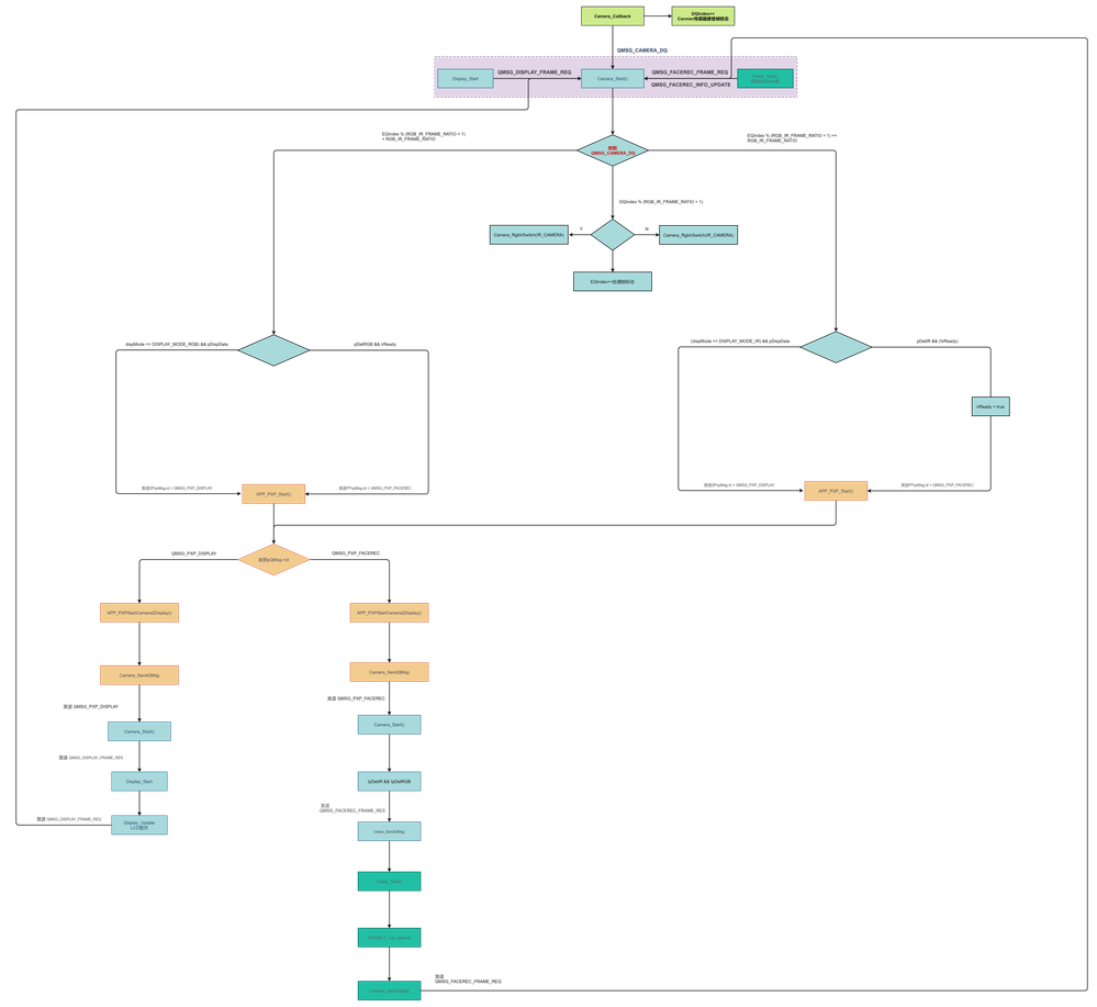

Fig4 SLN-VIZNAS-IOT software flowchart
sln_viznas_iot_elock_oobe's workflow flow
  1. In the Camera_Start() function, the task (Camera_Init_Task) completes the initialization of the RGB and IR cameras, then creates a task (Camera_Task);
  2. In the Display_Start() function, after the task (Display_Init_Task) completes the initialization of the display medium (USB or LCD), it immediately creates the task (Display_Task) and sends the message queue s_DisplayReqMsg.id = QMSG_DISPLAY_FRAME_REQ to the task (Camera_Task), then the pDispData will point to the s_BufferLcd[0] array for storing the image data to be displayed;
  3. In the Oasis_Start() function, firstly, OASISLT_init() completes the initialization of the OAISIT library, then creates a task (Oasis_Task) to send the message queues gFaceDetReqMsg.id = QMSG_FACEREC_FRAME_REQ and gFaceInfoMsg.id = QMSG_FACEREC_INFO_UPDATE to the task (Camera_Task) to make the pDetIR and pDetRGB point to the face block diagram captured by the RGB and IR cameras, and update the content pointed by infoMsgIn.
  4. After the camera is initialized, the RGB camera works at first. After the image data is captured, an interrupt is triggered and the callback function Camera_Callback() sends the message queue DQMsg.id = QMSG_CAMERA_DQ to the task (Camera_Task), and DQIndex++;
  5. CAMERA_RECEIVER_GetFullBuffer() extracts the image data captured by the RGB camera, and sends the message queue DPxpMsg.id = QMSG_PXP_DISPLAY to the task (PXP_Task) created in the APP_PXP_Start() function and EQIndex++, meanwhile switch the camera from RGB to IR. After the APP_PXPStartCamera2Display() function in the task (PXP_Task) completes processing, it sends the message queue s_DResMsg.id = QMSG_PXP_DISPLAY to the task (Camera_Task), and the task (Camera_Task) sends the message queue DresMsg.id = QMSG_DISPLAY_FRAME_RES to the task (Display_Task) after receiving the above message queue. The task (Display_Task) completes display, then it sends the message queue s_DisplayReqMsg.id = QMSG_DISPLAY_FRAME_REQ to the task (Camera_Task) to make pDispData point to the s_BufferLcd[1] array;
  6. After the IR camera completes capturing work, CAMERA_RECEIVER_GetFullBuffer() extracts the image data and sends the message queue DPxpMsg.id = QMSG_PXP_DISPLAY to the (PXP_Task) task created in the APP_PXP_Start() function, continue to execute EQIndex++ and switch to RGB camera again, and repeat the steps 5. Finally, send the message queue FPxpMsg.id = QMSG_PXP_FACEREC to the task (PXP_Task) and set irReady = true. After the task (PXP_Task) receives the above message queue, it calls APP_PXPStartCamera2DetBuf() and after completes the processing, sends the message queue s_FResMsg.id = QMSG_PXP_FACEREC to the task (Camera_Task);
  7. CAMERA_RECEIVER_GetFullBuffer() extracts the image data collected by the RGB camera, repeat step 5, when (pDetRGB && irReady) condition is met, send the message queue FPxpMsg.id = QMSG_PXP_FACEREC to the task (PXP_Task) and set irReady = false, pDetRGB = NULL, pDetIR = NULL. After the task (PXP_Task) receives the above message queue, it calls APP_PXPStartCamera2DetBuf() and after completes the processing, sends the message queue s_FResMsg.id = QMSG_PXP_FACEREC to the task (Camera_Task). At this time, the (!pDetIR && !pDetRGB) condition is met and the Queue message FResMsg.id = QMSG_FACEREC_FRAME_RES is sent to the task (Oasis_Task), run OASISLT_run_extend to perform face recognition calculation, and send the message queue gFaceDetReqMsg.id = QMSG_FACEREC_FRAME_REQ to the task (Camera_Task) to make the pDetIR and pDetRGB point to the face block diagram captured by the RGB and IR cameras again.
  8. keep repeat steps 6 and 7;
Fig5 sln_viznas_iot_elock_oobe's workflow flow

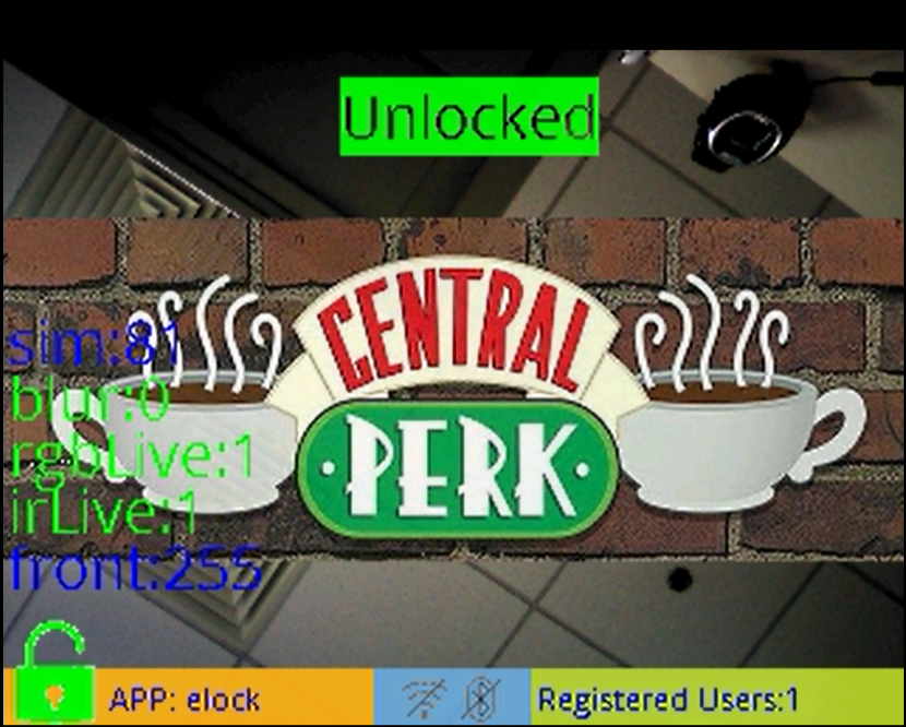

Smart Coffee machine

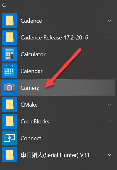

Fig 6 is the workflow of the smart coffee machine that I want to develop for, as there is no LCD board on hand,
in the below development process, I will select Win10's camera (as the below figure shows) to output the captured image, further, take advantage of the Shell command to simulate the LCD's touch feature to interact with the board.
Fig6 workflow of the smart coffee machine
Fig7 Camera

  • Use the cafe logo of《Friends》to replace the original Welcome_home picture, use the BmpCvt tool to convert the picture into the corresponding array, and add it to welcomehome_320x122.h.
static const unsigned short Coffee_shop_320_122[] = {

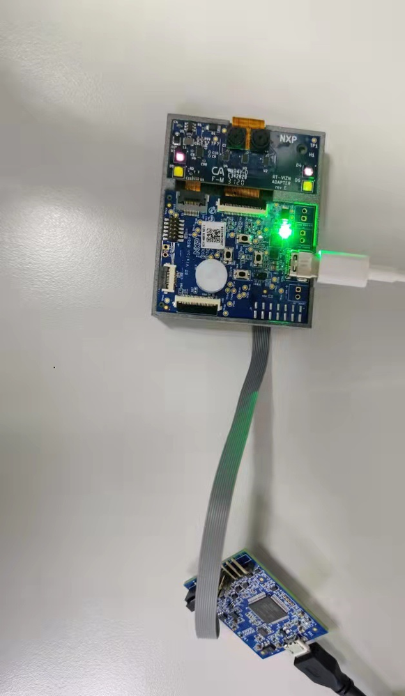

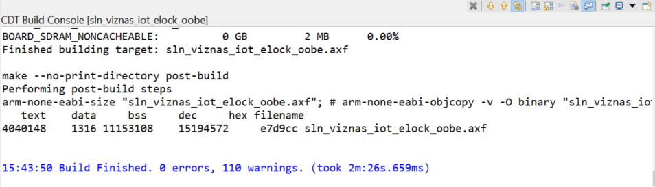

Programming the new project
After saving the modified code and recompile the sln_viznas_iot_elock_oobe project (as shown in the figure below), then connect the MCU-LINK to J6 on the SLN-VIZNAS-IOT, just like Fig9 shows.
Fig8 Recompile code
Fig9 MCU-LINK

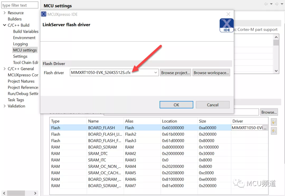

(Note: it needs to reselect the Flash driver, as the below figure shows.)
Fig10 Flash driver
After that, it's able to program the code project to the on-board Hyperflash.
Test & Summary
When the new code project boot-up, please refer to Get Started with the SLN-VIZNAS-IOT to use the serial terminal to test the newly added three Shell commands: orders, set_taste, and get_taste. Once a face is successfully recognized, the cafe logo will appear up (as shown in Fig11).
Fig11 Cafe logo
