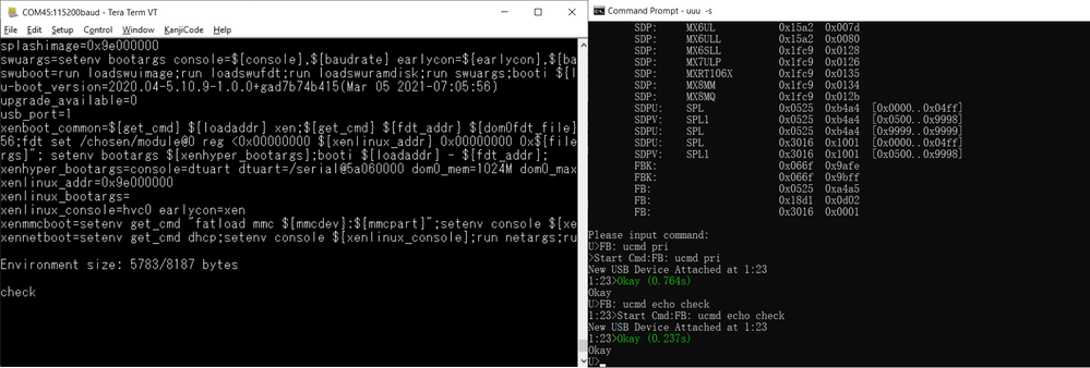

BiyongSUN
FB here is FastBoot in u-boot for uuu.
customer need to check the BSP version and if it is from NXP official release.
in u-boot console can use fastboot command if fastboot is enabled.
you also can use ums command
or using fastboot in u-boot and on the pc side uuu -s to attach and manual check the FB command in the uuu console on pc.
everything is in the uuu document
Here is using uuu shell mode "uuu -s "
FB: ucmd pri
FB: ucmd echo check
