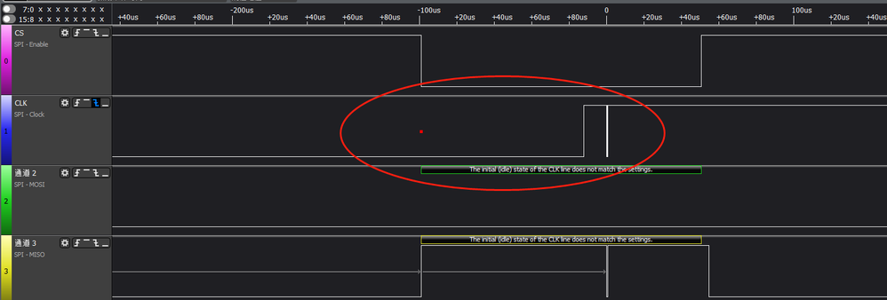

in custom board, i use ecspi1 controller two devices,  dts as follow:
ecspi1 {
   fsl,spi-num-chipselects = <2>;
   cs-gpios = <
      &gpio5 9 0
      &gpio3 5 0
   pinctrl-names = "default";
   pinctrl-0 = <&pinctrl_ecspi1_1 &pinctrl_ecspi1_spi0 &pinctrl_ecspi1_spi1>;
   status = "okay";
   spi0: spidev0 {
      #address-cells = <1>;
      #size-cells = <1>;
      compatible = "rohm,dh2228fv";
      spi-max-frequency = <20000000>;
      reg = <0>;
   spi1: spidev1 {
      #size-cells = <1>;
      reg=<1>;
when kernel start, i use app operate spidev1 to read devid,  it's failed to get it in first time, and soon on  i read it again, it's always ok. only first read error.
when kernel start, i read spidev0 devid in first time, it's always ok contain first time. wha't wrong with it, help me
i use logic analyize the wave when first read spidev1, wave form as follow:
please ignore mosi, before operate ecspi1, i config spi works mode3, but i found CLK is low in idle in first transfer, again test wave about spidev1, i can read fine devid, CLK wave is high in idle about its wave, what's wrong with it at first time, please help me, thanks

Hi he
for such weird behaviour one can try to rebuild all image from scratch, try
with minimal configuration. Use nxp bsps described on
i.MX Software and Development Tools | NXP
igor
