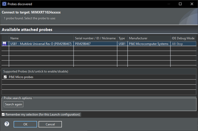

Hi!
I am currently successfully running my (Debug and Release) applications using "Debug Configurations..." but now I only want to flash the image on my board and it does not work.
I am using a PE Micro Multilink Universal with MCUXpresso IDE v11.6.1 on Windows 10 to debug and flash.

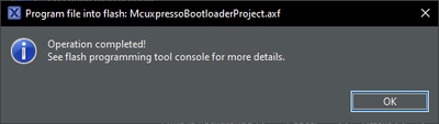

When clicking the "GUI Flash Tool" icon, I get the following window, where I select the .axf file for the image to flash. I then click "Run..."
I end up in the "Probes discovered" window, where I click "OK", which leads me to a prompt telling me that the operation succeeded.
But nothing happens on the board, and when I look at the "GUI Flash Tool console for PE Micro probes", I get this output:

I made a diff of this output with the one of a collegue for which it worked and saw that the following lines are only in my log:
Unable to load libusb0.dll
I updated "GNU ARM PEMicro Interface Debugging Support" and even uninstalled and reinstalled MCUXpresso but neither did help.
Any ideas on what the problem could be and how to fix it?
Thanks!

Just to keep this ticket updated, I don't know why but now it works.
There has been many Windows 10 and MCUXpresso SDK updates in the mean time, I guess it might have fix a setup error in my environment.
