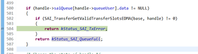

I have configured USB Audio Speaker.
Here is tx_callback
static void tx_callback(I2S_Type *base, sai_edma_handle_t *handle, status_t status, void *userData)
	global_var_struct_t *global_var_struct_ptr;
	global_var_struct_ptr = &global_var_struct;
    if (kStatus_SAI_RxError == status)
    else
    	global_var_struct_ptr->free_sai_tx_queue = SAI_TransferGetValidTransferSlotsEDMA(base, handle);
And in USB Audio Thread I'm requesting to send a new pack of sound data when
if (global_var_ptr->free_sai_tx_queue != 0){
After a random couple of minutes (can be 10 or 30) audio is stopped playing. USB looks like kept working. But when I connected to debug I see this:
    if (handle->saiQueue[handle->queueUser].data != NULL)
    	if (SAI_TransferGetValidTransferSlotsEDMA(base, handle) != 0)
    		return kStatus_SAI_TxError;
        return kStatus_SAI_QueueFull;
So there is a queue of 4 elements. There are 2 slots available, and SAI trying to request a transfer on the busy slot.  What could cause this?
