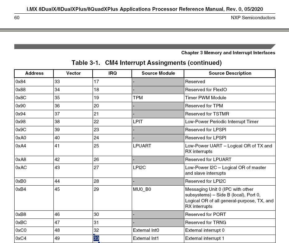

I'm confused about how the interrupt sources are mapped to the IRQSTEER. Here is a use case to illustrate:
I want the M4_0 to use LSIO GPT_4. The interrupt ID of GPT_4 is 167. I could experimentally figure out that this interrupt source #167 is routed to IRQSTEER_1 and becomes vector 33 to the M4 core. But how I derive 33 from 167?
I'd appreciate it if someone could elaborate on the process or point me to relevant documentation.

M4 has it's own NVIC, table below (it is from i.MX8QXP Reference Manual,
but for i.MX8QM it is the same) shows "external interrupt" vectors -
"external" interrupts are mapped to IRQSTEER module, so
IRQSTEER_1 becomes vector 33 to the M4 core.
i.MX 8DualXPlus/8QuadXPlus Applications Processor Reference Manual
igor

IRQSTEER_0  External Interrupt 0  IRQ=32  (Ints 0-63 from Table 3-4. Shared Peripheral Interrupts)
IRQSTEER_1  External Interrupt 1  IRQ=33 (Ints 64-127 from Table 3-4. Shared Peripheral Interrupts)
e.t.c.
