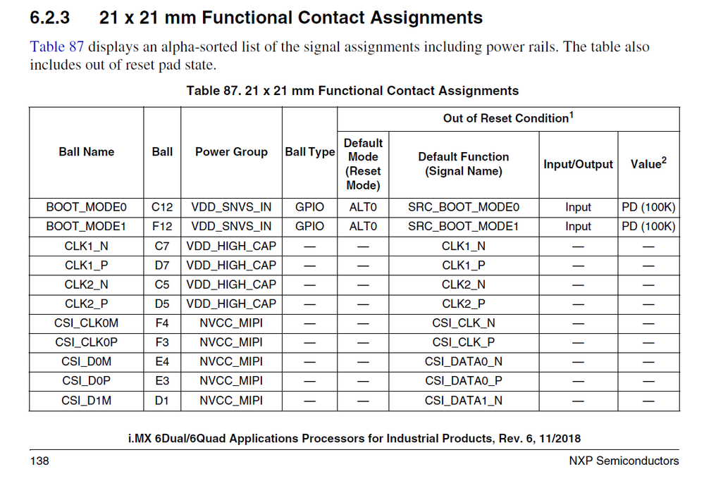

smithcoba
Jorge,
It is boot mode pin not the common function pin.
How we can check the PAD configuration?
It is totaly hardware.
In i.MX6 datasheet, we can know the pull down and value. such as PD(100K).
In i.MX8MP we only can know pull down and no value.
That information is very important for hardware design of boot.
