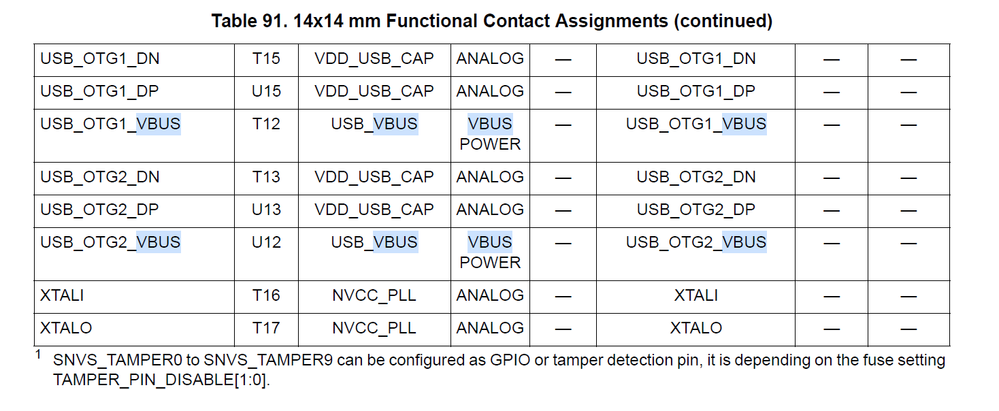

Debugging further, it's giving me mxs_phy 20c9000.usbphy: vbus is not valid. My vbus is connected to pin T12 as shown in schematic below.
pin T12 is USB_OTG1_VBUS, but I dont find any pad definition for this pin in scripts/dtc/include-prefixes/arm/imx6ul-pinfunc.h. Is there any thing I am missing How should I configure this pin in device tree if there is no definition in imx6ul-pinfunc.h?

USB_OTG1_VBUS pad has not alternative functions, so there is no
its settings in dts file.
