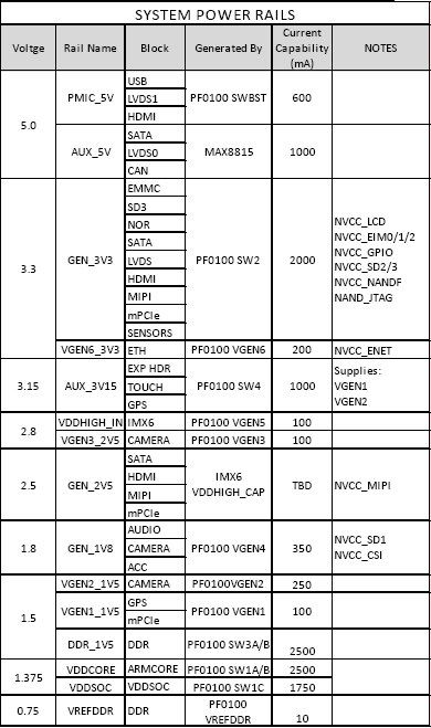

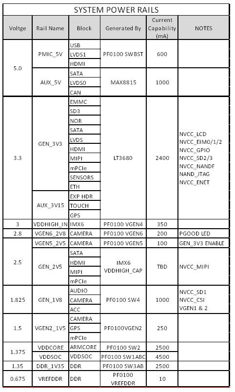

Yes we use the second configuration. That second configuration should work both for QP and Q.
I am not sure I understood your response though:  """ So one can check linux sources and schematic for that usage.""""
What does this have to do with linux sources? Or, why do you suspect a power supply issue? The board, in some cases, runs for hours without a problem as I mentioned in my original post. That should eliminate any supply/sequencing issues I presume?

igorpadykov
second configuration requires linux modifications for Q images,
had you implemented them.
NXP linux sources use Q first configuration and there is no
compatibility with second. Also i.MX6QP has some modules which are
absent in i.MX6Q, these should be excluded from linux build.

hakanaydin
Our power stage design is based on QP (SPF-28857). However, we populated our board with a Q and in order to create the SD card image for our board, we use the files/configuration for SABRE Q as a reference. Are you saying this is a problem? What in linux exactly deals with the power infrastructure?
5,097 Views
igorpadykov
so you used i.MX6Q configuration, right? Then you should change for example
pmic sw2 configuration, because in i.MX6QP design it is used differently.

david_dicarlo
I saw this thead and thought I'd jump in to clarify a little further.
The configuration of the PMIC (which outputs are ganged together and what supply they're connected to) is slightly different between the original i.MX6Q SDB and the i.MX6QP SDB because of the additional current demands of the Plus device.
The linux image for the board needs to be modified to match the particular PMIC configuration used. The board choices in Yocto doesn't accommodate placing an i.MX6Q onto an i.MX6QP SDB because the board choice options in stock Yocto only support the NXP evaluation hardware as configured.
Not being a software person, I can't speak to what needs to change and where, but I believe changes need to be made in the device tree configuration for the board. There may be additional things that need to be done to uboot, DCD table and linux, but someone more versed in software would need to analyze that (I provide predominantly hardware support for i.MX).

igorpadykov
Hi Hakan
SABRE 6QP (spf-28857) board uses some different power supplies than SABRE 6Q (spf-27392)
in particular SW2. So one can check linux sources and schematic for that usage.
