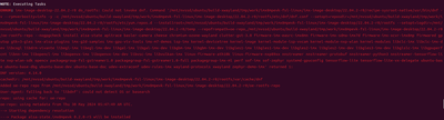

We then executed `bitbake -f imx-image-desktop` to compile, but encountered the following error:
ERROR: pytorch-2.0.0-r0 do_package_qa: QA Issue: /usr/lib/python3.11/site-packages/torch/test/test_parallel contained in package pytorch requires libstdc++.so.6(GLIBCXX_3.4.30)(64bit), but no providers found in RDEPENDS:pytorch? [file-rdeps]
ERROR: pytorch-2.0.0-r0 do_package_qa: Fatal QA errors were found, failing task.
ERROR: Logfile of failure stored in: /mnt/nvssd/ubuntu/build-desktop/tmp/work/armv8a-fsl-linux/pytorch/2.0.0-r0/temp/log.do_package_qa.2061988
ERROR: Task (/mnt/nvssd/ubuntu/sources/meta-imx/meta-ml/recipes-libraries/pytorch/pytorch_git.bb:do_package_qa) failed with exit code '1'
"log.do_package_qa.2061988.log" file is the full log

After making these changes and running `bitbake -f imx-image-desktop` again, the compilation reached the `do_rootfs` stage but still failed, with the error logged in `log.do_rootfs`.
"log.do_rootfs.2059955.log" file is the full log
