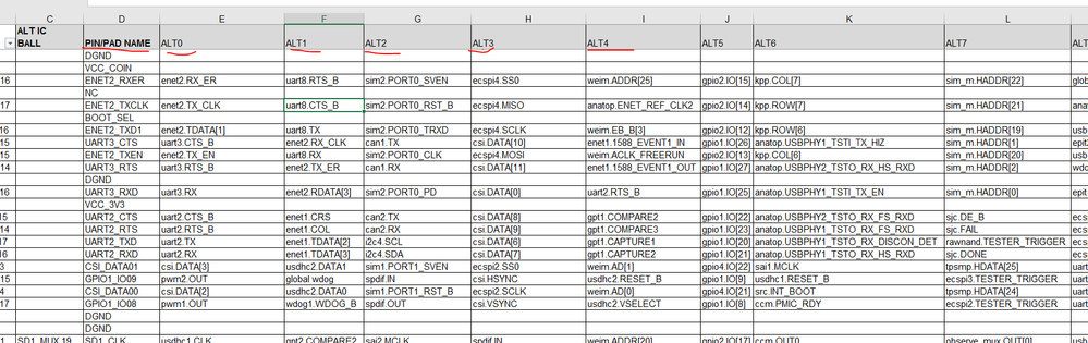

On the old version of the pins tool, there was an option to extract a list with the various MODE/ALT function per pad name. On the latest tool, I cannot find how to extract the table in the previous format.
Please guide me how to perform it.
Note that the old tool does not have new parts in it. Is there a way to load "manually" a CPU to get the required list sorted to ALT function?

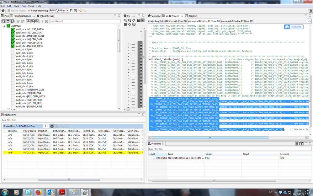

Hi Oded,
    I took i.MX6Q as an example to test it in i.MX Pins Tool v4.1, ALT mode has been listed in pin_mux.c generated automatically by the tool, see below, please!
Have a nice day!
Weidong

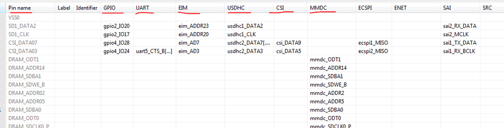

I am looking for a map of all the pins on a single sheet, not just the one I choose.
The display below was formatted with the old tool such that each column list different alternate function per pin:
New tool example:
Old tool format looked similar to this layout (extracted from xls):
We are in the business of SOM creating and it is a must for the documentation.
Please help me get this view in the new tool.
Is there a way to disable specific pins?
Is there a way to add a custom column to the display?
Thanks for the support
