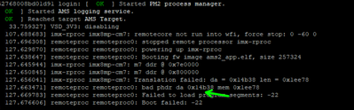

I am trying to enable remoteproc to control M7. imx_rproc driver seems to be working.  I am using the following device tree (at post end) . I have seen limited success , I am able stop start and load demo app firmware provided by mcuexprosso. How ever the existing firmware that we were using is not working.
The firmware(.bin) works fine with u-boot. But when i try to use firmware(.elf) using remoteproc it fails to kick complaining about address translation failed  . I have looked into the issue and attached some relevent info below but i dont see any obvious issue. My guess is the linker script provided by MCUexpresso has some issue or i am not using it correctly.
[ 1683.199889] remoteproc remoteproc0: powering up imx-rproc
[ 1683.208037] remoteproc remoteproc0: Booting fw image ams2_app.elf, size 257324
[ 1683.215523] imx-rproc imx8mp-cm7: Translation failed: da = 0x14b38 len = 0x1ee78
[ 1683.222972] remoteproc remoteproc0: bad phdr da 0x14b38 mem 0x1ee78
[ 1683.229270] remoteproc remoteproc0: Failed to load program segments: -22
[ 1683.236023] remoteproc remoteproc0: Boot failed: -22

My understanding is it should try to translate and load VirtualAddress . But it seems to be trying to load PhyAddress . Am i missing something? Please look At the screenshots attached.

Which elf did you use -> FreeRTOS based proprietary  application that we developed  It uses RPMSG-Lite to talk with host.
Since the elfs data section was not aligned with DTCM of iMX 8 Plus . It was crashing. We had 2 options.
Edit the linker script provided in MCUExpresso as mentioned in this thread https://community.toradex.com/t/error-in-m4-ocram-linker-file/8354/15
Or in the imx-rproc driver we could redefine ITCM and DTCM as a single TCM block. For now we have gone with the second option and are able to load FW.
Thank you for your help . We are stuck with different issue currently I will start a new thread for that.

I've hit the same problem as OP. Turned out there's bug in elf loader code. It uses physical address instead of virtual and puts stack+heap+bss in ITCM instead of DTCM. To hit that bug, your code+bss+stack+heap must be larger than the size of ITCM (0x20000 = 128K). You can modify stock examples by increasing stack and heap appropriately and they won't work either.
Here's the fix:
--- a/drivers/remoteproc/remoteproc_elf_loader.c
+++ b/drivers/remoteproc/remoteproc_elf_loader.c
@@ -173,7 +173,7 @@ int rproc_elf_load_segments(struct rproc *rproc, const struct firmware *fw)
/* go through the available ELF segments */
for (i = 0; i < phnum; i++, phdr += elf_phdr_get_size) {
- u64 da = elf_phdr_get_p_paddr(class, phdr);
+ u64 da = elf_phdr_get_p_vaddr(class, phdr);
u64 memsz = elf_phdr_get_p_memsz(class, phdr);
u64 filesz = elf_phdr_get_p_filesz(class, phdr);
u64 offset = elf_phdr_get_p_offset(class, phdr);
