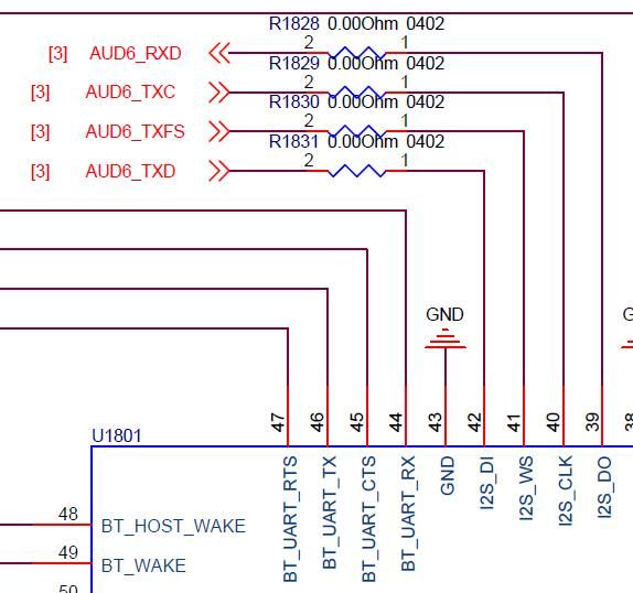

     the FM Chip is BCM4334(BT+WIFI+FM), the FM data be send by bcm4334, it is master, the wave is ok.
     now i have integrate the code to imx6, fm.apk has in android system. when i open fm.apk, it no sound.

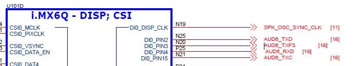

     we are use AUD6_RXD connect I2S_DO, AUD6_TXC connect I2S_CLK(1.5MHz), AUD6_TXFS connect I2S_WS(48kHz)
     i had add the code imx_audmux_config(plat_data->src_port, plat_data->ext_port); to my codec code.
     i know i have some mistake in the code , but i don't know how to use the AUDMUX, and can let FMRaido have sound, please give me some suggestions , thank you

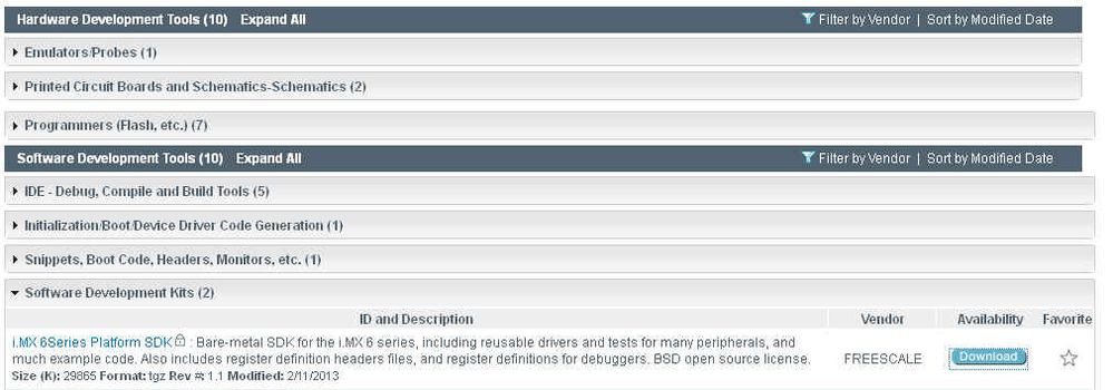

hi igor:
     can you proivde me the iMX6_Firmware_Guide.pdf  web link,  i can't found this file in http://www.freescale.com/webapp/sps/site/prod_summary.jsp?code=RDIMX6SABREBRD&fpsp=1&tab=Design_Tool...
3,555 Views
igorpadykov
please look at attachment
~igor
