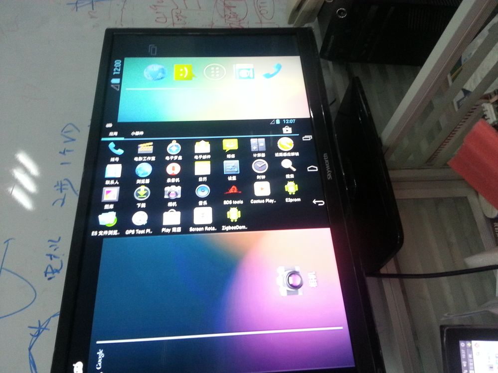

Hello everyone, I encountered a trouble!
I want to achieve mipi lcd and hdmi displayed simultaneously, but seeing the results as shown below
Ipu channel my configuration is as follows:
static struct mipi_dsi_platform_data mipi_dsi_pdata = {
    .ipu_id        = 1,
    .disp_id    = 1,
    .lcd_panel    = "TRULY-WVGA",
    .reset        = mx6_reset_mipi_dsi,
    .lcd_power  = mx6_lcd_power_mipi_dsi,
    .backlight_power = mx6_backlight_power_mipi_dsi,
static struct fsl_mxc_hdmi_platform_data hdmi_data = {
    .init = hdmi_init,
    .enable_pins = hdmi_enable_ddc_pin,
    .disable_pins = hdmi_disable_ddc_pin,
static struct fsl_mxc_hdmi_core_platform_data hdmi_core_data = {
    .ipu_id = 0,
    .disp_id = 0,
static struct fsl_mxc_lcd_platform_data lcdif_data = {
    .ipu_id = 0,
    .disp_id = 0,
    .default_ifmt = IPU_PIX_FMT_RGB24,
static struct fsl_mxc_ldb_platform_data ldb_data = {
    .ipu_id = 0,
    .disp_id = 1,
    .ext_ref = 1,
    .mode = LDB_SPL_DI0,
    .sec_ipu_id = 0,
    .sec_disp_id = 0 ,
imx6q_add_mipi_dsi(&mipi_dsi_pdata);
//    imx6q_add_lcdif(&lcdif_data);
    /*lvds display register platfrom data*/
//    imx6q_add_ldb(&ldb_data);
    imx6q_add_v4l2_output(0);
My  kernel cmdline  is as follows:
BOARD_KERNEL_CMDLINE := console=ttymxc0,115200  init=/init video=mxcfb0:dev=mipi_dsi,TRULY-WVGA,if=RGB24,bpp=32 video=mxcfb1:dev=hdmi,1920x1080M@60,bpp=32 video=mxcfb2:off vmalloc=450M androidboot.console=ttymxc0 androidboot.hardware=freescale
please tell how to solve !!

Hi li yu, you can add "setprop hwc.g2d.blit false" in init.rc to avoid this issue.

Hi   :
        Qiang Li ,
          Currently lvds primary screen, hdmi as a second screen, because my lvds screen is not 1080P resolution, it will lead to
hdmi display only the middle region,
Is there any way to make hdmi as the main screen, lvds as a second screen,
Now my uboot environment variables
mxcfb0: dev = hdmi, 1920x1080P60, bpp = 32 mxcfb1: dev = ldb, 1024x768P60, bpp = 32 ,
lvds to display properly, but the kernel will complain hdmi
,as is the kernel print information

You can try with "video=mxcfb0:dev=hdmi,1920x1080M@60,bpp=32 video=mxcfb1:dev=ldb,LDB-XGA,bpp=32 fbmem=28,20".
3,589 次查看
liyu1
Now without error, but hdmi still can not display , lvds normal
3,589 次查看
liyu1
现在不会出现错误,但是hdmi还是不能显示
3,589 次查看
qiang_li-mpu_se
Please attach your full kernel boot up log and logcat here. Thanks!
3,589 次查看
liyu1
hi :
    Qiang Li
   mipi dsi uboot logo smooth start
   android 4.2.2 lvds and hdmi support smooth start, but  official  did not release an patch about mipi dsi smooth start, and if you can provide this patch?
         Thanks !
3,589 次查看
qiang_li-mpu_se
Sorry, there is no such patch and no such plan too.
