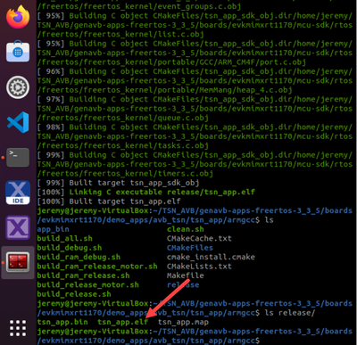

jeremyzhou
Sorry for replying late.
Actually, I don't encounter the build issue after following the
NXP_GenAVB_TSN_MCUXpresso_User_s_Guide_3_3_rev1, you can see that I can generate the image.
TIC
13,931 Views
usala
Jeremy,
You are building the wrong project and the release build not the debug build.
From: genavb-apps-freertos-3_3_5\boards\evkmimxrt1170\demo_apps\avb_tsn\avb_audio_app\armgcc\
run ./build_debug.sh and you'll see the issue as in the original attachment.
Ulises
