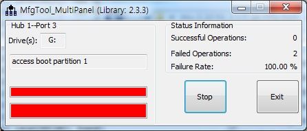

I tried to write eMMC in i.MX6Q SABRE-SDP using IMX6_L3.10.53_MFG_TOOL.
And example operation in 'Manufacturing Tool V2 Quick Start Guide.docx' is not working.
It looks like suitable for only old type.
Please tell me other reference describing cfg.ini and ucl2.xml for eMMC writing in SABRE-SDP for MFGTOOL2 not old type.

I set cfg.ini but still have error.
MfgTool.log is here.
DLL version: 2.3.3
Tuesday, March 31, 2015 10:52:40   Start new logging
ModuleID[2] LevelID[1]: Load command--file C:\work\02_freescale\01_i.MX6\08_sabre_platform\imx-3.10.53_1.1.0_ga-mfg-tools\mfgtools-with-rootfs\mfgtools\Profiles\Linux\OS Firmware\firmware\zImage-imx6sx-17x17-arm2-emmc.dtb failed to open.errcode is 2
ModuleID[2] LevelID[1]: Parse ucl script failed, error code: 4

if you are using i.MX6Q SABRE-SDP, then
how "zImage-imx6sx-17x17-arm2-emmc.dtb" appeared in your log ?

My last log is below. Have you ever seen this error?
DLL version: 2.3.3
Thursday, April 02, 2015 12:43:19   Start new logging
ModuleID[2] LevelID[10]: CMyExceptionHandler thread is running
ModuleID[2] LevelID[1]: new MxHidDeviceClass
ModuleID[2] LevelID[10]: DeviceTypeDisk--_devices size: 1
ModuleID[2] LevelID[10]: Volume--StorageDisk, Disk->_driveNumber:2, Volume->_diskNumber:2
ModuleID[2] LevelID[10]: DeviceTypeDisk--find Disk device: 0078C810
ModuleID[2] LevelID[10]: Device::hubIndex::getmsc, return the port index is: 3
ModuleID[2] LevelID[10]: Device Manager thread is running
ModuleID[2] LevelID[10]: CmdOperation[0] device chagned and reset to state 1
ModuleID[2] LevelID[10]: ExecuteCommand--Push[WndIndex:0], Body is send
ModuleID[2] LevelID[10]: ExecuteCommand--Push[WndIndex:0], Body is $ tar xf $FILE
ModuleID[2] LevelID[10]: ExecuteCommand--Push[WndIndex:0], Body is $ sh mksdcard.sh /dev/mmcblk0
ModuleID[2] LevelID[10]: ExecuteCommand--Push[WndIndex:0], Body is $ dd if=/dev/zero of=/dev/mmcblk0 bs=1k seek=384 conv=fsync count=129
ModuleID[2] LevelID[10]: ExecuteCommand--Push[WndIndex:0], Body is $ echo 0 > /sys/block/mmcblk0boot0/force_ro
ModuleID[2] LevelID[1]: PortMgrDlg(0)--MSCDevice--Command Push(no file) excute failed
