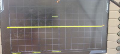

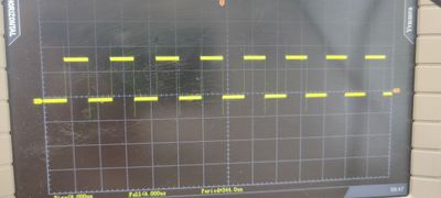

Hanging timer interrupts on the LED pin by m4 app. Before linux is fully started, the meander is displayed correctly. After a full start, the meander breaks off and does not work as it should. Tried adding epit1 epit2 status disabled in the device tree, nothing changed.
Before starting linux
After starting linux 

Please advise in which direction to look
