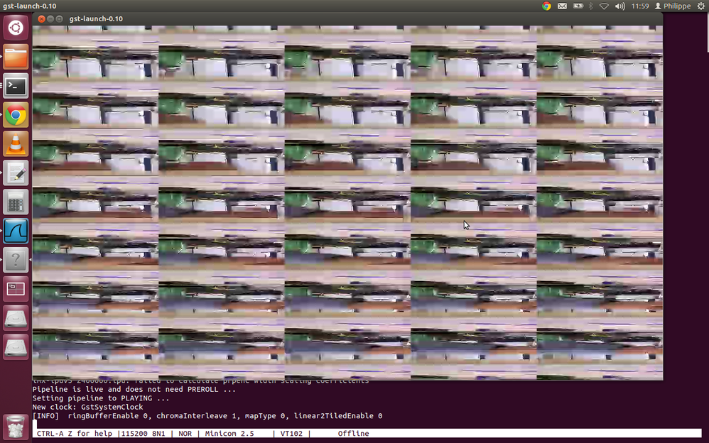

I've built the image fsl-image-multimedia (dizzi branch) on the BD-SabreLite and i'm trying to stream the OV5640 camera (port J5) over the the network
Here is the 2 gstreamer commands i'm using:
- Sender:
gst-launch v4l2src device=/dev/video0 ! 'video/x-raw-yuv,width=1280,height=720,framerate=30/1' ! ffmpegcolorspace ! vpuenc codec=6 ! rtph264pay ! udpsink host=192.168.20.31 port=5000
- Receiver:
gst-launch udpsrc port=5000 caps="application/x-rtp, media=(string)video, clock-rate=(int)90000, payload=(int)96, encoding-name=(string)H264" ! rtph264depay ! ffdec_h264 ! xvimagesink
This seems to work, but not correctly
See in attachment a screenshot of what it looks like:
Any ideas of what may cause this?
Any pointers would be of great help.

Found the solution.
Sender:
gst-launch mfw_v4lsrc capture-mode=4 rotate=3 fps-n=30 fps-d=1 ! ffmpegcolorspace ! vpuenc codec=6 ! rtph264pay ! udpsink host=192.168.20.31 port=5000
Receiver
