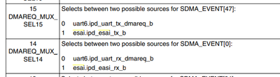

I am working on i.MX6ULL and there is an issue I am facing with SDMA remapping.
When I am configuring the sdma remapping event as below, I am able to run the audio on ESAI channel,
&sdma {
gpr = <&gpr>;
/* SDMA event remap for ESAI */
fsl,sdma-event-remap = <0 14 1>, <0 15 1>;
But, I am experiencing an hang on UART6 bus.
Can anyone point me how the settings are causing issue on UART6?
I can see the datasheet shows below register IOMUXC_GPR_GPR0 field descriptions,
Does that mean that when ESAI is run on SDMA mode, UART6 cannot be used?

Does that mean that if SDMA is used on SAI1 channel then we cannot use the UART4 for the system?
Similarly with iMX6ULL, usage of SDMA on ESAI channel means that we cannot use UART6 in the system?

igorpadykov
Hi Kiran
yes. In such case one can try to use uart without sdma (remove UART6 sdma entries in dts).
