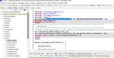

I am running the RT1064 EVK board.  MCUXpresso IDE v11.5
I am trying to convert the 'composite_hid_audio_unified' sample to synchronous audio transmission.  When enabling the ‘USB_DEVICE_AUDIO_USE_SYNC_MODE’ define it requires a CTimer implementation (specifically ‘fsl_ctimer.h’)
I can’t find what should be enabled through the ‘Manage SDK Components’ menu to make this work.  Does someone know how CTimer can be enabled?

Hi @mrecoskie ,
    I already get the internal information.
   For USB IP on RT4bit series chip, it doesn't have the SCTimer to adjust the audio clock. So our SDK for RT4bit series only use the Asynchronous mode. Actually, the Asynchronous mode is the most reliable way to sync usb audio.
   Please help to check, whether your Host do not support the Asynchronous mode or not?
   If you must use the Asynchronous mode, please let me know, our internal side have ever implemented a project that use synchronous mode, it uses the sof interrupt to adjust the audio pll, but I still don't have it, if you need it, we will apply for it internally.
   So, please tell me, whether you must need to use synchronous mode.

kerryzhou
Hi @mrecoskie ,
   I think, you mention this part:
In fact, the ctimer is not the RT1064 peripheral, it is the RT600&LPC peripheral, that's why you can't add it.
So, ctimer can't be used in the RT10XX.
Wish it helps you!
