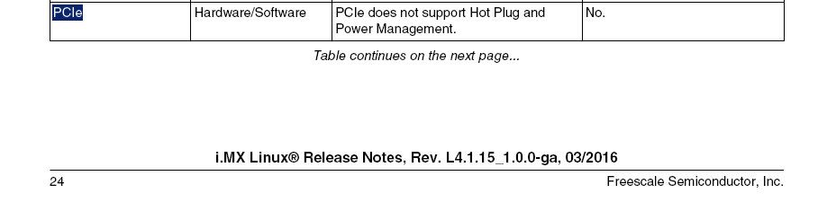

igorpadykov
Hi Donlim
please refer to attached Release Notes Table 13. Known issues

Thanks for your response.
I understood that Hot Plug for PCI-e does not supported in i.MX 6Q SABRE-AI board.
Please let me know whether NXP has a workaround plan about Hot Plug or not.
To reboot the board is the best solution for re-plug PCI-e?
