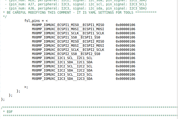

We are building a custom board using the Imx8mp processor.
I was going through the device tree thats present in the source and came across the pin mux configuration in the dts and the dtsi files.
Example snippet from dts:
pinctrl-names = "default";
pinctrl-0 = <&pinctrl_hog>;
pinctrl_ecspi2: ecspi2grp {
fsl,pins = <
MX8MP_IOMUXC_ECSPI2_SCLK__ECSPI2_SCLK 0x82
MX8MP_IOMUXC_ECSPI2_MOSI__ECSPI2_MOSI 0x82
MX8MP_IOMUXC_ECSPI2_MISO__ECSPI2_MISO 0x82
pinctrl_ecspi2_cs: ecspi2cs {
fsl,pins = <
MX8MP_IOMUXC_ECSPI2_SS0__GPIO5_IO13 0x40000
pinctrl_gpio_led: gpioledgrp {
fsl,pins = <
MX8MP_IOMUXC_SAI2_RXC__GPIO4_IO22 0x19
MX8MP_IOMUXC_SAI2_RXFS__GPIO4_IO21 0x19
MX8MP_IOMUXC_SAI2_RXD0__GPIO4_IO23 0x19
MX8MP_IOMUXC_SAI2_TXFS__GPIO4_IO24 0x19
MX8MP_IOMUXC_UART4_RXD__GPIO5_IO28 0x19
After going through the datasheets and reference manuals and some digging on the internet i came across the NXP provided pin config tool which generates the PIN mux config also.
But when I select these pins (for ex ECSPI2) the Pinmux tool generates completely different addresses.
And weirdly its generating the same address (106) nomatter what peripheral I add. (Snippet below)
So in actuality how do I get these addresses of these pins?
How do i proceed further to add our own peripherals to the custom board??
How can i add these adresses as a part of the device tree and get the board working?

Even After going through the file I've not exactly understood how to get the adresses, as I'm looking at one of the dts files which uses the imx8mp (i.e the humming board pulse from solidrun), say ecspi2 node
&iomuxc {
fsl,pins = <
fsl,pins = <
How did These adresses arrive? 0x82 and 0x40000
Why do all the SCLK, MOSI, MISO have same adresses
Why do the adresses of the above 3 and CS look different?
Also, say i want to reconfigure one of the SAI pins as a GPIO and add the node in my dts, how can i get the adresses? How can i do it? Or more simply put how can i take any pin from the processor configure it as either an LED or a pushbutton?
Please provide us an elaborate answer as we are facing trouble regarding the same and we don't have much support...Thanks in advance!
