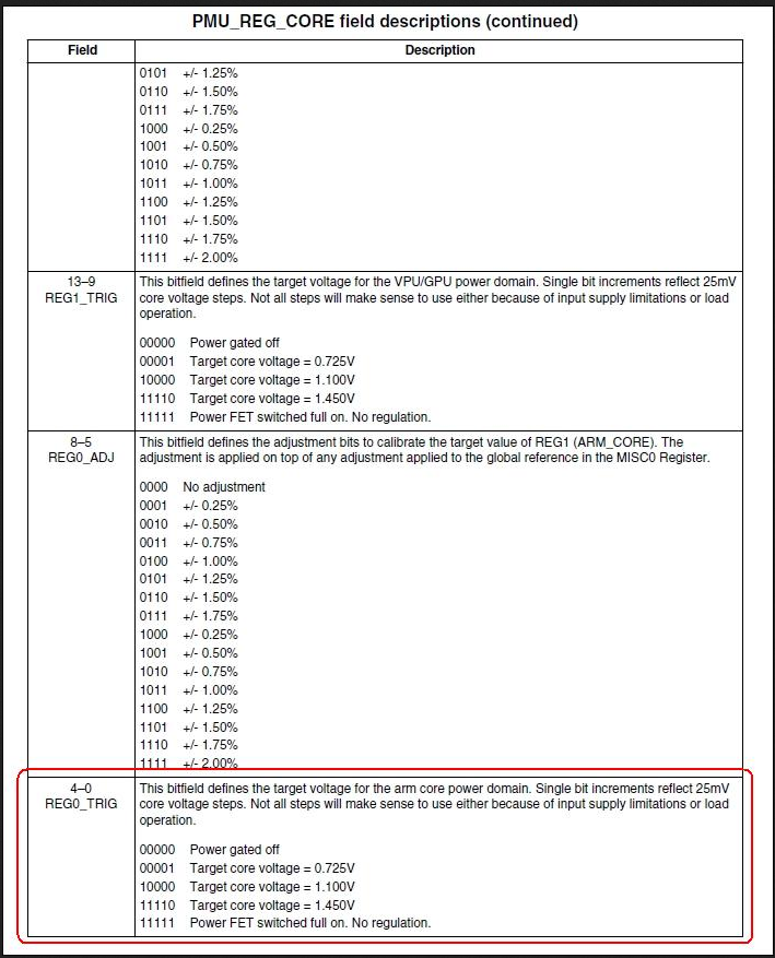

inderjitbains
For #3:  Chapter 4 of the HW Development Guide does not have any recommendations for the rate of the output voltage change is controlled by the Dynamic Voltage Scaling (DVS).  This is not a power-on sequence issue:  when the voltage is scaled, the rate of change must be set.  Will the highest setting of 12.5mV/us (25mV / 2us) work?

reyes
Yes, 12.5mV/us will work, in fact any of the DVS setting would work since, as can be seen in the image below, the iMx6 is compatible with 25mV voltage steps and all the DVS settings are derivate from this voltage.
Also, if needed, you can change the DVS setting during normal operation, OTP sets the initial voltage (for boot up or normal operation) and that can be changed over I2C (DVS).
