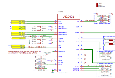

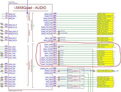

We are trying to setup A2B AD2428 sound card with custom IMX8QM based board.On the following pictures is shown how A2B master AD2428 is connected to the IMX8QM audio subsystem:

We tested the same driver with A2B master eval kit https://www.analog.com/en/design-center/evaluation-hardware-and-software/evaluation-boards-kits/EVAL.... We connected EVAL-AD2428WD1BZ over M.2 slot to IMX8QM-MEK evaluation board where connection to the audio subsystem is over SAI0. In that test setup everything works fine, the playback as well as recording.
For our custom board where A2B master is connected over ESAI1 the only change in the driver that we needed to make to initialize the A2B master successfully was in file imx-adau-a2b2428.c in function imx_hifi_hw_params():
Afterward it initializes properly and playback works fine.
Since everything works fine with EVAL-AD2428WD1BZ on IMX8QM-MEK we believe that A2B related parts of driver source code are fine and that the problem is somewhere in configuration of IMX8QM audio subsystem and ESAI1.
Could anyone, please, check whether we are doing anything wrong in attached device tree and the driver source code?

That is the default configuration on IMX8QM-MEK device tree for ESAI0 but now on ESAI1.
