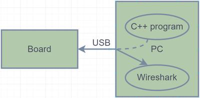

Maybe you can try to use Wireshark to monitor and capture data go through the USB device which is sent by the C++ program, it can help you to figure out whether the C++ program sends the expected data.
