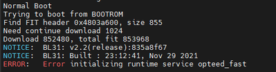

008kai
Thank you for your reply. I modified it according to the steps you mentioned, but still encountered the following error:
I am using the verdin-imx8mp development board, is it caused by the lack of some steps? thanks
