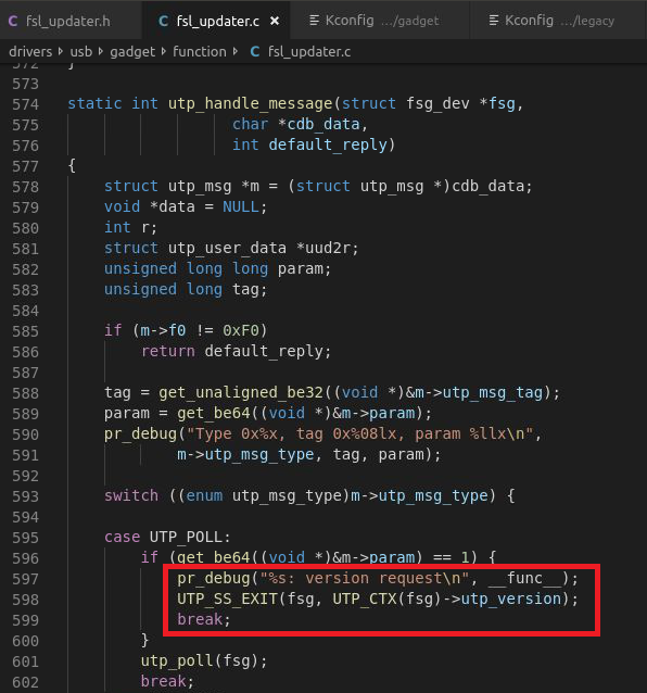

We've migrated our bsp from 4.1.15-2.0.0 to 4.14.98-2.0.0 on one of our imx6d board.
Everything works but MfgTool.
I noticed that FSL_UTP's dependence have been moved from USB_MASS_STORAGE to USB_CONFIGFS_MASS_STORAGE
So I use a modified linuxrc script in imx-uuc to mount usb storage:

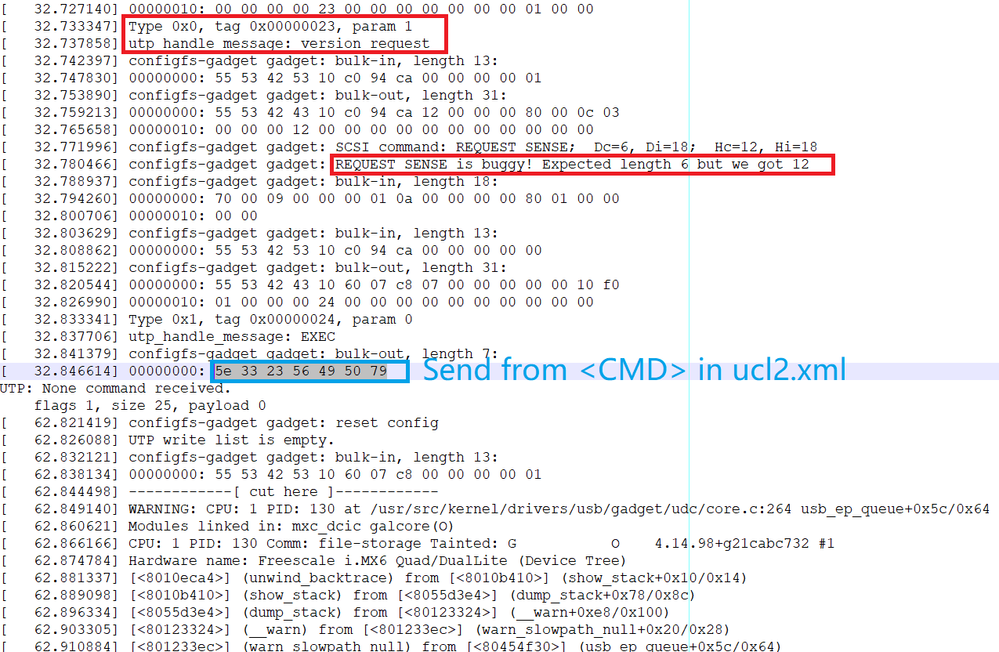

Seems work, But when I click start button on MfgTool, this error happened

Hi 计龙 杨
mfg tool is not supported in latest nxp bsps, as described in
Linux L4.14.98_2.0.0 Documentation
It is replaced by uuu tool
GitHub - NXPmicro/mfgtools: Freescale/NXP I.MX Chip image deploy tools.
igor
