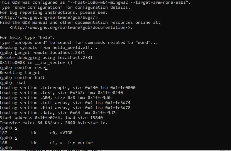

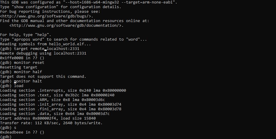

I am having some difficulty debugging the SDK's hello world program from DDR on the Cortex M4. Similar issues have arisen before for others on the imx6, as documented here and here .  In the referenced issues, the jtag debugger was setting software breakpoints in DDR instead of the cache, leading to some undesirable inconsistencies when the cache was enabled.
In my case, the debugger immediately steps to 0xdeadbeef on the very first instruction of the reset vector. The reset value of the LMEM enable at 0xe0082000 is zero according to the TRM. Furthermore, the hello world program does not enable the cache until the SystemInit call. For these reasons, I am inclined to think that my problem is a bit different from the imx6 issues.
GDB works as desired when running the program out of TCM.

Below are a pair of screenshots showing the differing behavior for DDR and TCM based code. I reset power on the unit between tests.
DDR:
TCM RAM:
EDIT: I should also add that the DDR program runs normally when no breakpoints are enabled.
