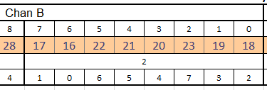

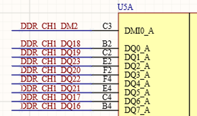

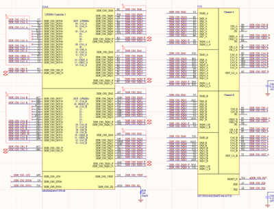

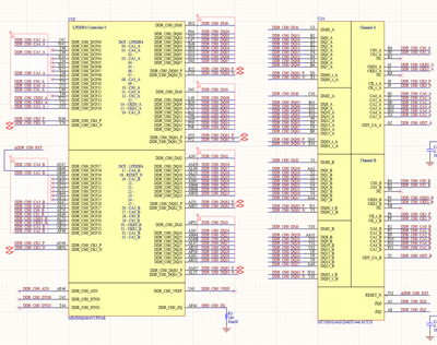

I've checked the connections between iMX8 and LPDDR4 and verified in RPA Excel sheet and it looks correct. I've tried changing the ODT and drive strenghts without any luck.
Schematic is copied from MEK with some minor DQ changes in same bytelane.
We've used the .cfg file from RPA and put that in the SCFW .CFG file for 1.6GHz and also used the script from the RPA excel for the DDR Stress test.

Hi Viktors94,
The reason for this issue may be wrong memory connections or incorrectly configured "BoardDataBusConfig" parameters in the RPA tool.
Looking into the lines DQ lines DDR_CH1_DQ22 it appears declared on the BoardDataBusConfig incorrectly:
So this can be causing the error.
Israel.
