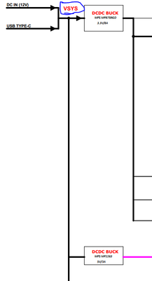

thanhle1990
Hi, Dhruvit
As I had some investigation before, the issue ware caused by missing of power supply for HDMI.
The power from USBC PD did not become the main power source, as I read from another post, USBC PD on this board was not designed for power supply, so I gave up the idea.
6,382 Views
Dhruvit
Hi @thanhle1990,
As indicated in the Power topology (image attached below), After the VSYS is generated, there is a common power path going ahead in power sequence irrespective of the power source. So, DCDC_5V rail will be genrated in both the cases (DC jack power source or USB Type C power source).
