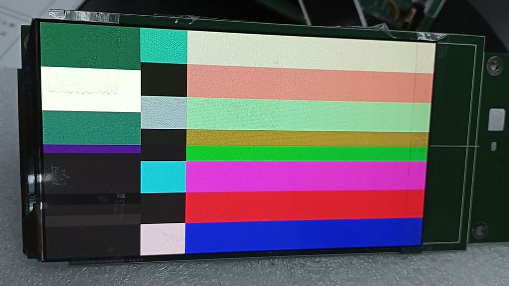

We are encountering the display issue.
Hardware: NXP i.MX8M Mini SOM + our function board + third-party rm67199 based panel
OS: Linux 6.1.22
This is the first time we use panel to connect to our board. The original driver panel-raydium-rm67191.c is used with small change on the default mode per the panel vendor's advice, as below:

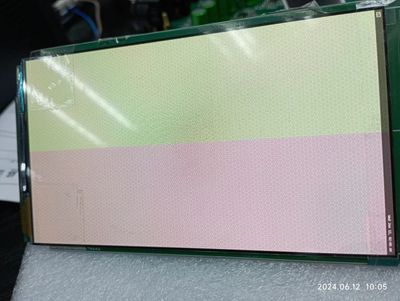

Now the system can boot up with "4 penguins" and then the background picture shown on the screen. However the color on the left half of screen is incorrect (the right half looks normally), as below:
Then we got the tool modetest for testing the display functionality. The output image of modetest (command: # modetest -s 35@33:1080x1920@XR24), is as below:
I also found that the display color of left screen should be incorrect by comparing to the modetest output on normal display system.
No obvious errors of panel driver and libdrm are found from the kernel log. The log may be not detailed enough.
Any tips for this issue are highly appreciated.

Check the clock in device tree apparently is not correct.
1,265 Views
fsong
Thanks a lot for your tip. Current clock setting in device tree:
 lcdif@32e00000 {
#address-cells = <0x01>;
#size-cells = <0x00>;
compatible = "fsl,imx8mm-lcdif";
reg = <0x32e00000 0x10000>;
clocks = <0x02 0x6b 0x02 0xcd 0x02 0xce>;
clock-names = "pix\0disp-axi\0disp-apb";
assigned-clocks = <0x02 0x6b 0x02 0x55 0x02 0x56>;
assigned-clock-parents = <0x02 0x28 0x02 0x41 0x02 0x38>;
assigned-clock-rate = <0x2367b880 0x1dcd6500 0xbebc200>;
