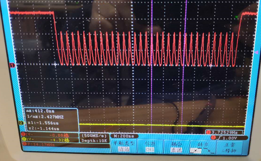

Hi, I use IMX6ULL and there is a extern RAM connect via EIM interface. I want to do read/write extern RAM, but it failed.
I captured the EIM_CS0 signal and found the signal is very strangely.
Why the EIM_CS0 become LOW so long(more than 2us)?
and Why there is 32 noise while EIM_CS0 is LOW?
------------------------------------------------------------------my use case and configuration
//EIM clock confige 100MHZ
CLOCK_SetMux(kCLOCK_EimSlowMux, 2);
CLOCK_SetDiv(kCLOCK_EimSlowDiv, 1);
//EIM register confige, which is refer the Reference Manual
EIM->CS0GCR1 = 0x403104b1;
EIM->CS0RCR1 = 0x0b010000;
EIM->CS0RCR2 = 0x00000008;
EIM->CS0WCR1 = 0x0b040040;
//test case(read memory)
data = *((REG16 *)0x50000000);

Hi liqi
for adjusting EIM parameters may be useful to look at app note
Interfacing Spansion® GL MirrorBit® Family to Freescale™ i.MX31 Processors
https://www.cypress.com/file/207256/download
and sect.4.9.3 External Interface Module (EIM)
i.MX 6ULL Applications Processors for Consumer Products
