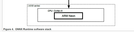

1, From below picture, It seems ONNX only support running in CPU on NXP? Does ONNX support running in NPU? Which EPs are supported?

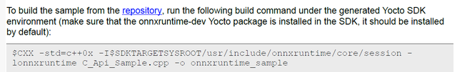

2, Build file C_Api_Sample.cpp, I need cross-compiling tool, How to generate this toolchain?

1 >> Yes, Onxx only runs on the CPU.
2 >> You have to follow the next steps to generate the toolchain:
Install the repo utility:
$: mkdir ~/bin
$: curl http://commondatastorage.googleapis.com/git-repo-downloads/repo  > ~/bin/repo
$: chmod a+x ~/bin/repo
$: PATH=${PATH}:~/bin
Download the Yocto Project BSP
$: mkdir <release>
$: cd <release>
$: repo init -u https://github.com/nxp-imx/imx-manifest -b <branch name> [ -m <release manifest>]
$: repo sync
Setup the build folder for a BSP release:
$: [MACHINE=<machine>] [DISTRO=fsl-imx-<backend>] source ./imx-setup-release.sh -b bld-<backend>
<machine> defaults to `imx6qsabresd`
<backend> Graphics backend type xwayland
Wayland with X11 support - default distro
wayland  Wayland
fb     Framebuffer (not supported for mx8)
Build SDK:
bitbake -c populate_sdk imx-image-full
Best Regards!

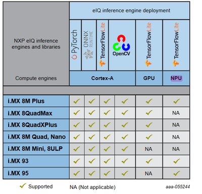

And I have a question, I get the information from the relase note in file "IMX-MACHINE-LEARNING-UG.pdf". Onnx can run VSI-NPU Execution provider and NNAPI Execution Provider in the previous version. But in the latest version, VSI-NPU and NNAPI been remove. Could you tell me why they been removed. Is it because of poor performance?
