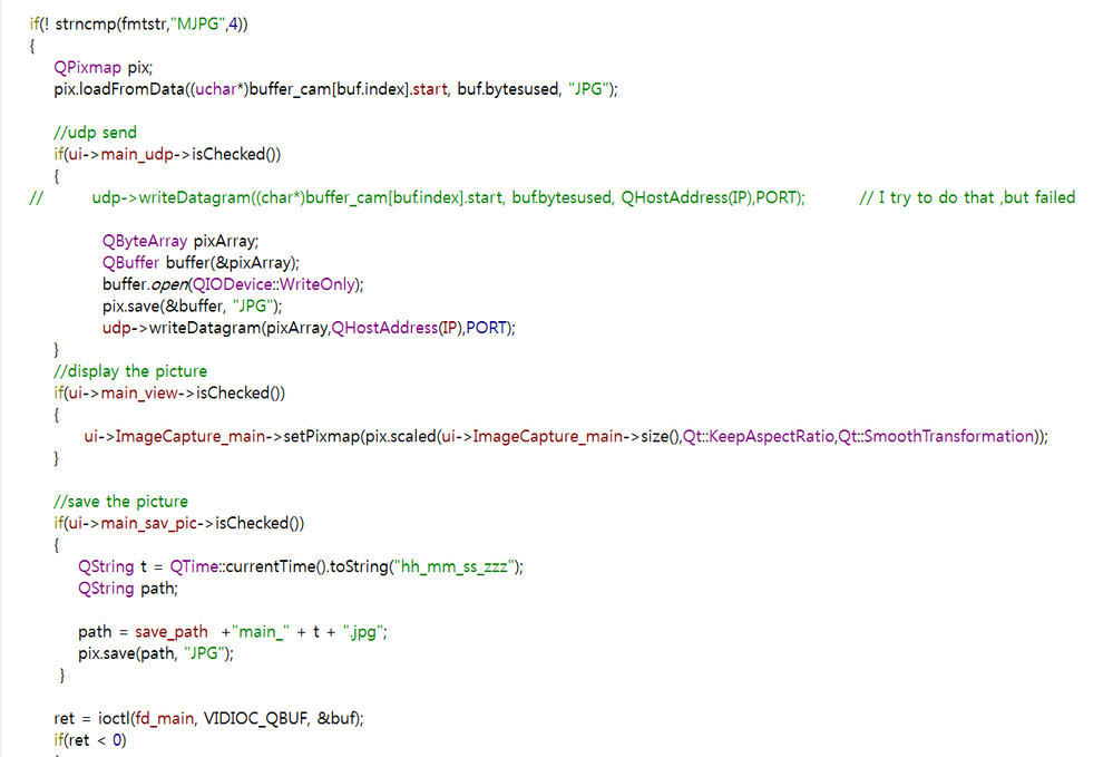

I use the V4L2 to read the usb camera, and then displayed on the qt with cpu, although successful, but it is not smooth.
Therefore, I want to use the GPU to read and display the usb camera. Is there any information or examples?
thank you very much.

This is my related functionality with qt, but consuming 120ms with QPiamap :: loadfromData and 148ms with QPixmap ::
save. Is there a more optimized way?

igorpadykov
Hi  振杰
please look at sect.13.2 Unit Test for gpu tests atatched Linux Manual.
Seems for camera better to use gstreamer, it is described in Linux Guide
sect.7 Multimedia, use nxp bsps described on
http://www.nxp.com/products/software-and-tools/software-development-tools/i.mx-software-and-tools/i....
igor

振杰司徒
thanks for your reply
But I'm worried I can not fully implement my function on a 720P camera by using gstreamer. Because I not only need to
display, but also saved as pictures and udp transmission.
