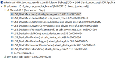

I'm developing a USB MSC disk application for a board based on an RT1010.
I have the following working:
- I receive a `kUSB_DeviceMscEventWriteRequest` event which sets up a buffer for the USB stack to fill.
- I receive a `
kUSB_DeviceMscEventWriteResponse` which contains the data received via USB.
- In the same place while handling the MSC event in `
USB_DeviceMscCallback()`, I pass the buffer to a function that handles the received data. That data could end up being sent via UART, written to Flash memory, etc.
The problem I have is that all of this is executed from `USB_DeviceMscCallback()` which is called from an interrupt context. What I want to do is buffer the received data in a queue, and process it later in a thread context.
I found an example project that seems to show what I'm looking for, but I don't understand how it works.
It looks like the example application changes something so that `USB_DeviceMscCallback()` is no longer called from an interrupt context, but from a thread context.
The application calls `xQueueReceive()`, not `xQueueReceiveFromISR()` when handling `kUSB_DeviceMscEventWriteRequest` .
How does the application make this work?
EDIT: another question would be: is it okay to make a blocking call to `xQueueReceiveFromISR()` in the USB interrupt context? Or what is the right way to handle write requests when my application doesn't have enough resources to buffer the incoming data?

3,998 Views
andyteufel
The ISR routine only check what the interrupt event is and then send message to USB stack thread.
It's the message sending I have an issue with. As you point out, on `USBDeviceMscRecv()`, the MSC class callback gets called to handle the kUSB_DeviceMscEventWriteRequest event.
Then `xQueueReceive()` is called there, from an interrupt context, blocking until the queue has a buffer available.
My questions are:
Why `xQueueReceive()` and not `xQueueReceiveFromISR()`? In the screenshot you posted you can clearly see in the call stack that the first function is `USBDeviceEhciIsrFunction()`.
How is the application affected if the queue blocks the execution of the interrupt?
How can I handle the case where my application is not returning the buffers to the queue fast enough so that `xQueueReceive()` returns a buffer immediately?
Thanks for your help. I hope my questions are understandable.

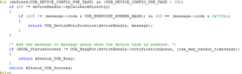

3,980 Views
jingpan
Hi @andyteufel ,
Yes, it's different. You can see related code in USB_DeviceNotificationTrigger().
USB_DEVICE_CONFIG_USE_TASK is only enabled in FreeRTOS project.
Jing

jingpan
Hi @andyteufel ,
A: You can see it's up to the RTOS. xQueueReceiveFromISR() is used in ISR routine. But here queue is received in thread.
A: xQueueReceive() is blocked in thread, not interrupt.
A:  Enlarge the buffer or give higher priority to this thread.
Jing
