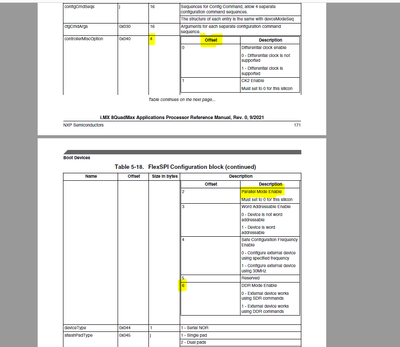

We are using two serial nor flashes connected to portA0 and PortB0 of flexspi0, We have configured our boot mode pin settings for the FlexSpi Boot as default. In this mode, we are observing uboot binary is being loaded on only one individual flash and booting up from the same. but now we want to load uboot binary in both flashes by enabling parallel flash mode and booting up the device in parallel flash mode by default. can you please provide some mechanism on how to enable booting from parallel nor flashes that are connected to FlexSpi as we are accessing both the flashes in Parallel flash configuration in our BM and Application as well.

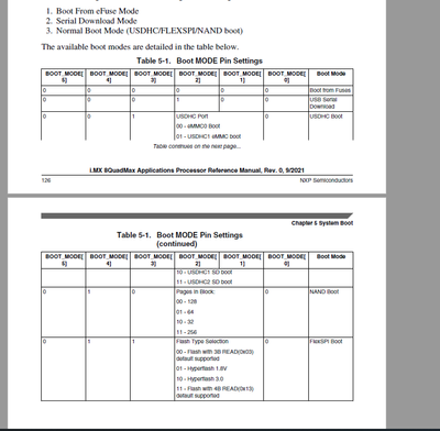

    Greetings! Actually, My query was not about how to implement Parallel Flash mode in Flex-Spi. We have already successfully developed our driver to run in Parallel Flash Mode and are able to access both Flash chips in parallel mode. My question was about how we can select the default boot device configuration as Flex-Spi with Parallel flash mode enabled. We have referred to the section 5.3.1 Boot Mode Pin Settings and 5.8.3 FlexSPI serial flash memory boot and configured our Boot mode settings. with our current configuration, we are able to set the Flex-Spi flash device as the default boot device whereas it was booting only from one Individual flash. but our requirement is it should boot in Parallel Flash Mode from both flash devices connected to Flex-Spi ports A0 and B0. Our current boot device configuration is as per Table 5-8. Boot Device Selection is 011000. so can you please help us if we have to do any further settings to configure the default boot device selection as FlexSpi Boot with Parallel Flash Mode enabled?
2) We have gone through the 5.8.3.3 FlexSPI configuration parameters but here we are seeing one setting is there to enable the parallel flash mode but it was not so detailed and one more observation is for a given size of 4 bytes there are 6 offsets given can you please elaborate more on this and how to enable this parallel flash setting?

Were you able to adjust in FlexSPI FCFB struct in QSPI flash at least serialClkFreq? So that FCFB is read at default low clock, then ROM switches to clearly higher clock specified in serialClkFreq and continues reading IVT and the rest of U-Boot at higher clock? At least you should start from verifying your changes in FCFB are applying.
When you are in touch with FCFB, try configuring FCFB for parallel mode. Don't forget about special parallel read command in LUT, which must provided via FCFB as well. When parallel FCFB is done, you need to program IVT and the rest of U-Boot image in parallel mode starting from right parallel mode flash offset. FCFB has to be programmed in single chip mode to just flash A (, or as well the copy of it in single chip mode to flash B, which won't be read by ROM anyway). Parallel mode, as you may know, interleaves data to A/B, FCFB should be readable from A in non parallel mode, so no data interleaving for FCFB.

Can you try the following?
  • Use attached fspi_header to replace the standard one in mkimage under the scripts directory
  • Build FSPI boot container using normal command
  • Run ./splitter.sh flash.bin, using the FSPI container built in the previous step - this should create 2 images (ImageA and ImageB)
  • Program flash devices in Linux
root@imx8dxlevk:~# cat /proc/mtd
dev:    size   erasesize  name
mtd0: 80000000 00080000 "gpmi-nand"
mtd1: 04000000 00010000 "5d120000.spi-0"
mtd2: 04000000 00010000 "5d120000.spi-2"
root@imx8dxlevk:~# flash_erase /dev/mtd1 0 10
Erasing 64 Kibyte @ 90000 -- 100 % complete
root@imx8dxlevk:~# dd if=ImageA of=/dev/mtd1
1196+0 records in
1196+0 records out
612352 bytes (612 kB, 598 KiB) copied, 0.824804 s, 742 kB/s
root@imx8dxlevk:~# flash_erase /dev/mtd2 0 10
root@imx8dxlevk:~# dd if=ImageB of=/dev/mtd2
1196+0 records in
1196+0 records out
612352 bytes (612 kB, 598 KiB) copied, 0.80508 s, 761 kB/s
root@imx8dxlevk:~#
After this parallel boot should be working. Let me know if this works for you.
Hector.
