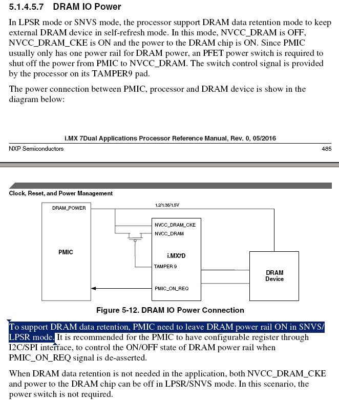

We’re working with a imx7D sabre board (EVK) and trying to test LPSR mode, but we’re not able to resume once the system enters the low power mode.
To enable LPSR, we modified the dts file per imx7d-12x12-lpddr3-arm2.dt (details below). Boot log shows message: LPSR mode enabled, DSM will go into LPSR mode!
We let the system enter LPSR mode via: “echo mem > /sys/power/state”  This results in power rails being disabled (except VSNVS and VLPSR).
However, once in LPSR mode, pressing the ON/OFF push button on the SABRE board results in the system cold booting (loading uboot and then OS) rather than resuming.
We're running the 4.1.15_ga_1.0.0 kernel and Yocto FS.
Did we miss something? Seems LPSR is supported on the arm2 board but I don't see any particular info on this configuration except the dts.
Thank you

igorpadykov
Hi Aaron
you are right, arm2 board populated with lpddr3 while sdb with ddr3
and NVCC_DRAM which powers ddr3, is turned off in lpsr mode.
In arm2 board lpddr3 has several ddr power lines (NVCC_DRAM, NVCC_DRAM_SW,
NVCC_1V8) which used differently.
Schematics (2)
Design files for i.MX 7Dual (REV D)
Design files, including hardware schematics, Gerbers, and OrCAD files for i.MX 7Dual (REV D)
http://www.nxp.com/products/microcontrollers-and-processors/arm-processors/i.mx-applications-process...

igorpadykov
According to lpddr3 jedec in self refresh mode power supply pins (VDD1, VDD2,
and VDDCA) must be at valid levels, while VDDQ may be turned off during Self-Refresh.
On ARM2 board NVCC_DRAM_SW power line is connected to processor
NVCC_DRAM and lpddr3 VDDQ and may be turned off during LPSR mode.
Following  ddr3 jedec for self refresh operation, all power supply and reference pins
(VDD, VDDQ, VSS, VSSQ, VRefCA and VRefDQ) must be at valid levels.
(VrefDQ supply may be turned OFF). In i.MX7D Sabre SD processor
NVCC_DRAM connected to memory VDD, VDDQ lines. So putting processor
to LPSR mode (Table 5-4. Power Mode i.MX7 RM) turns off NVCC_DRAM and
powers off memory, loosing all data.
igor

ericnelsonaz
The voltages are definitely not configured for power-off mode, and the SABRE SD equivalent of this patch for the mx7d_12x12_lpddr3_arm2 board is necessary to enable power to remain on for some rails.
It appears that some other changes to U-Boot are also needed though.
While trying to understand where DDR is taken out of self-refresh in LPSR mode, I ran across this patch for the mx7d_12x12_lpddr3_arm2 board. If I understand this correctly, the LPSR resume process actually boots through the boot rom, which will load U-Boot and that U-Boot must be configured with a plugin that operates out of internal RAM by un-commenting this #define in the board's configuration header file.
1,826 Views
