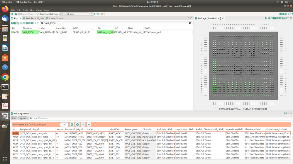

ylmzhsn_
Hi Sanket,
The reference guide I use:
The schematic  are attached.
imx8mpevk :
