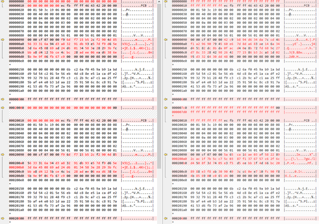

Dear All!
I have a custom board with an IMX6ULL on it.
It's set up to boot from NAND flash (MT29F2G08ABAGAWP)
I want to flash BCB area using u-boot command.
So I flashed BCB area as follow step
Step 1. Flash NAND boot(BCB) area using uuu command.
kobs-ng init -x -v --chip_0_device_path=/dev/mtd${NAND_uboot} /tmp/boot
Step 2. Update BCB area using u-boot command.
=> usb start
=> mw.b 0x81000000 0xFF 0x100000
=> fatload usb 0:1 0x81000000 u-boot.imx
=> nandbcb init 0x81000000 NAND_uboot ${filesize}​
But I found some dump value was different.
 (Compared uuu flashed hex dump value of BCB area with u-boot command hex dump value of BCB area)

These two nandbcb dump value is same like as belows
=> nandbcb dump NAND_uboot
device 0 offset 0x0, size 0x300000
NAND FCB read from 0x0 offset 0x400 read: OK
NAND FCB read from 0x20000 offset 0x400 read: OK
NAND FCB read from 0x40000 offset 0x400 read: OK
NAND FCB read from 0x60000 offset 0x400 read: OK
NAND DBBT read from 0x80000 offset 0x14 read: OK
NAND DBBT read from 0xa0000 offset 0x14 read: OK
NAND DBBT read from 0xc0000 offset 0x14 read: OK
NAND DBBT read from 0xe0000 offset 0x14 read: OK

<Question>
 1. Why these two hex dump values are different?
 2. Device that BCB area is flashed by u-boot command is, OK?
    (I want to use this nandbcb command if this method is OK)
