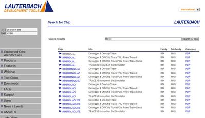

igorpadykov
Hi Kunal
unfortunately I am not aware of JLink scripts supporting Cortex-A53, may be recommended
to apply to segger directly:
https://forum.segger.com/index.php/Thread/4447-SOLVED-Cortex-A53-support/
NXP uses Lauterbach Trace32 as debugger tool for Cortex-A53 cores.
igor
10,450件の閲覧回数
kunalkotecha1
Senior Contributor II
Hi @igorpadykov,
Can you share the exact part number/model/version of the debugger that can be used with i.MX8MQ A53? The debugger product page will be an added help.
Kunal
10,445件の閲覧回数
igorpadykov
https://www.lauterbach.com/frames.html?home.html
igor
