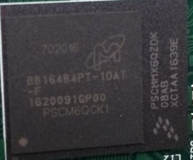

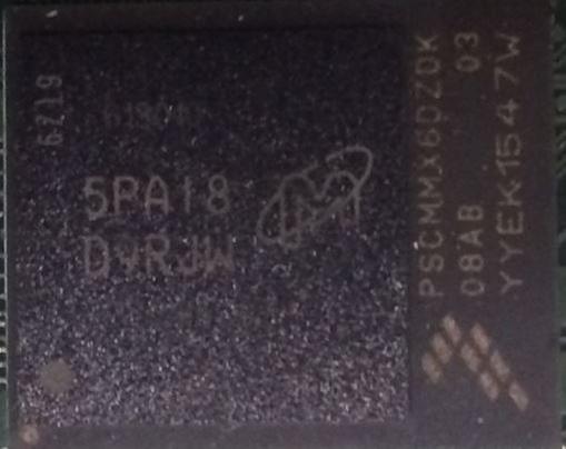

Thanks Artur. The images of each PoP are below. Do we need to adjust some timing settings with our DDR interface to get ENET working? Everything else on the new system (with the bottom "new" iMX6 PoP) seems to be working, so I'm not sure if we are having DDR issues...
iMX6 PoP that ENET works on:
iMX6 PoP that ENET does not work on:

There are two differences found between the SCM modules, shown on your pictures.
1. The "old" ("working") one is based on the i.MX6Dual processor, whereas the "new" ("non-working") one - on i.MX6Quad.
2. The memory chips are different.
Most likely, the chips have different memory size (1GByte and 2GByte options are available), so, the different BSP builds for different memory sizes should be run on them. Ask your SCM module vendor for memory options for each of them.
