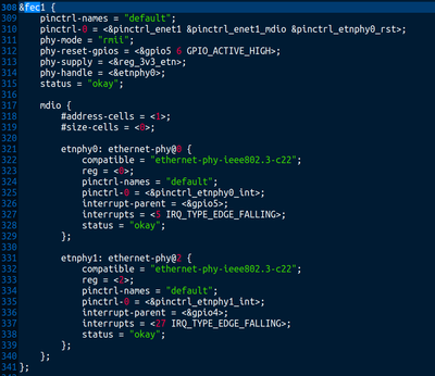

DTS changes are like

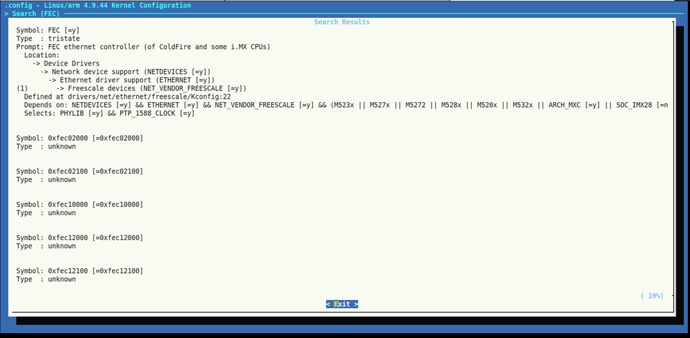

I have kept Ethernet FEC driver as Module instead of inbuilt
-CONFIG_FEC=y
+CONFIG_FEC=m

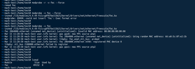

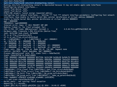

This driver is loaded during boot time only automatically. After that I am removing this FEC driver and insert again, but it will not loaded successfully and crashing kernel .
modprobe -r -v fec
modprobe -v fec
Log files are attached NXP_question_log.txt
Vardhman_Modi_1-1647423613174.pngVardhman_Modi_1-1647423613174.pngVardhman_Modi_2-1647423618222.pngVardhman_Modi_2-1647423618222.png
